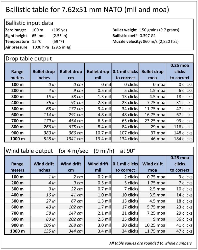

    Allegedly - if you have a 303 sight in 'yards' it is pretty close to the adjustments for 7.62 in 'metres'
Name:	762 Ballistic Table.png‎
