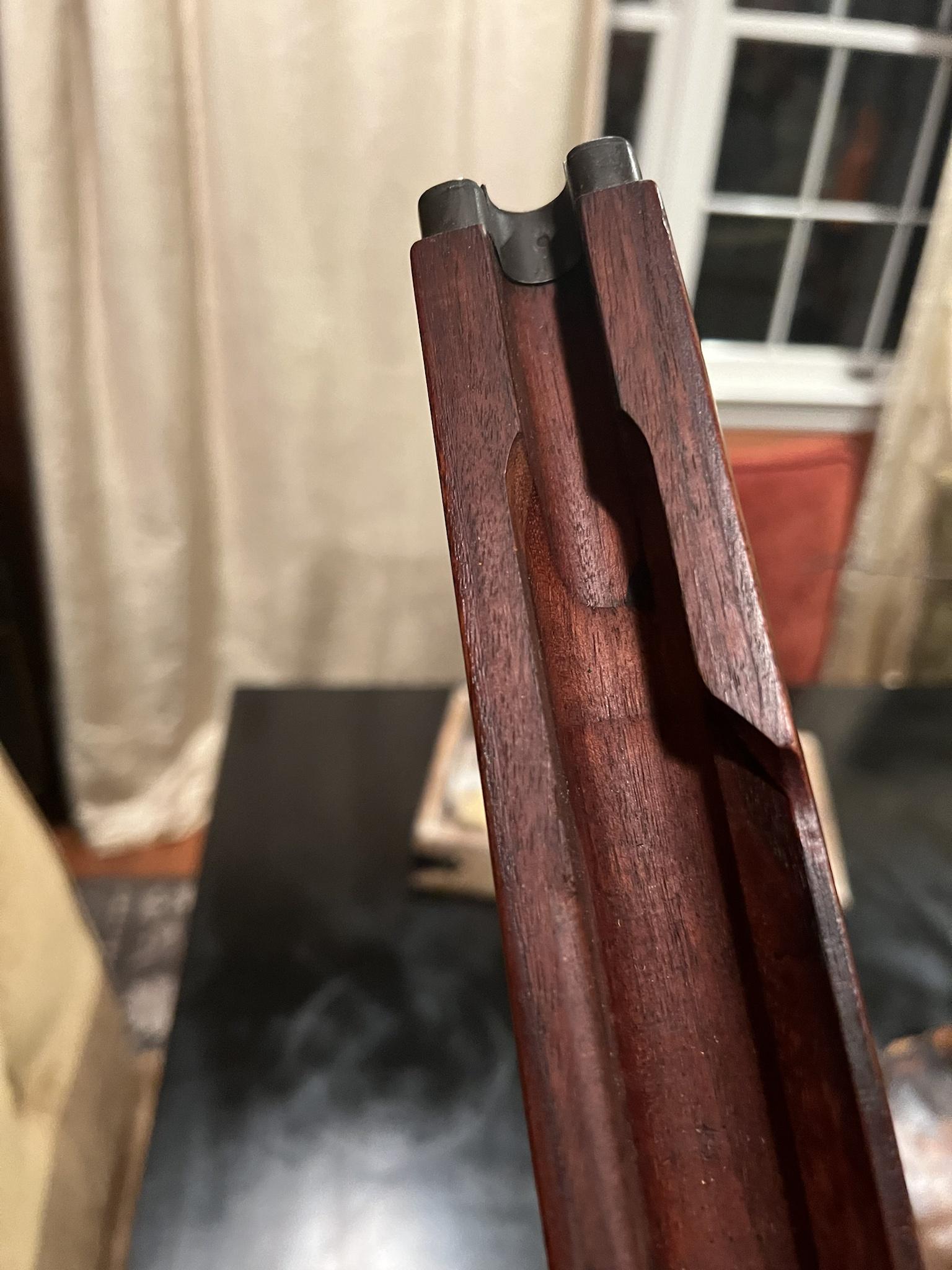

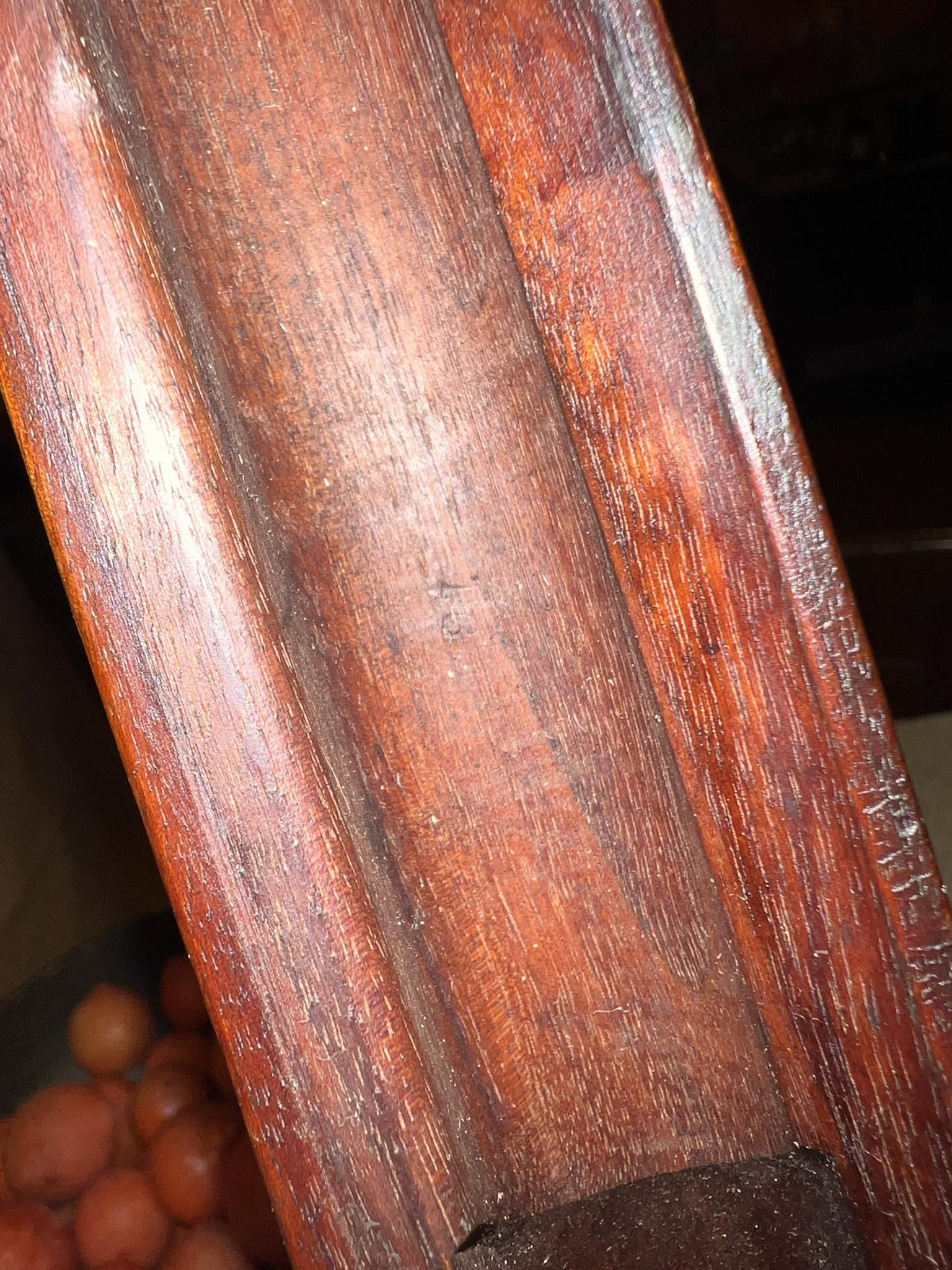

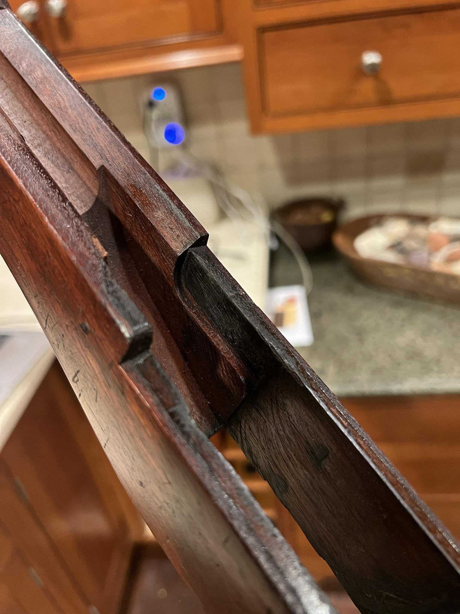

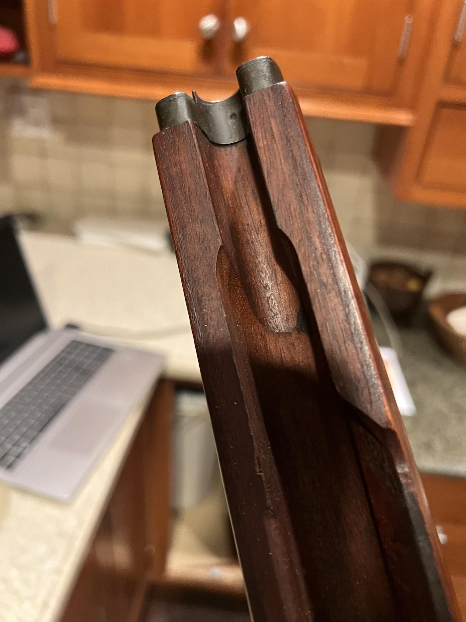

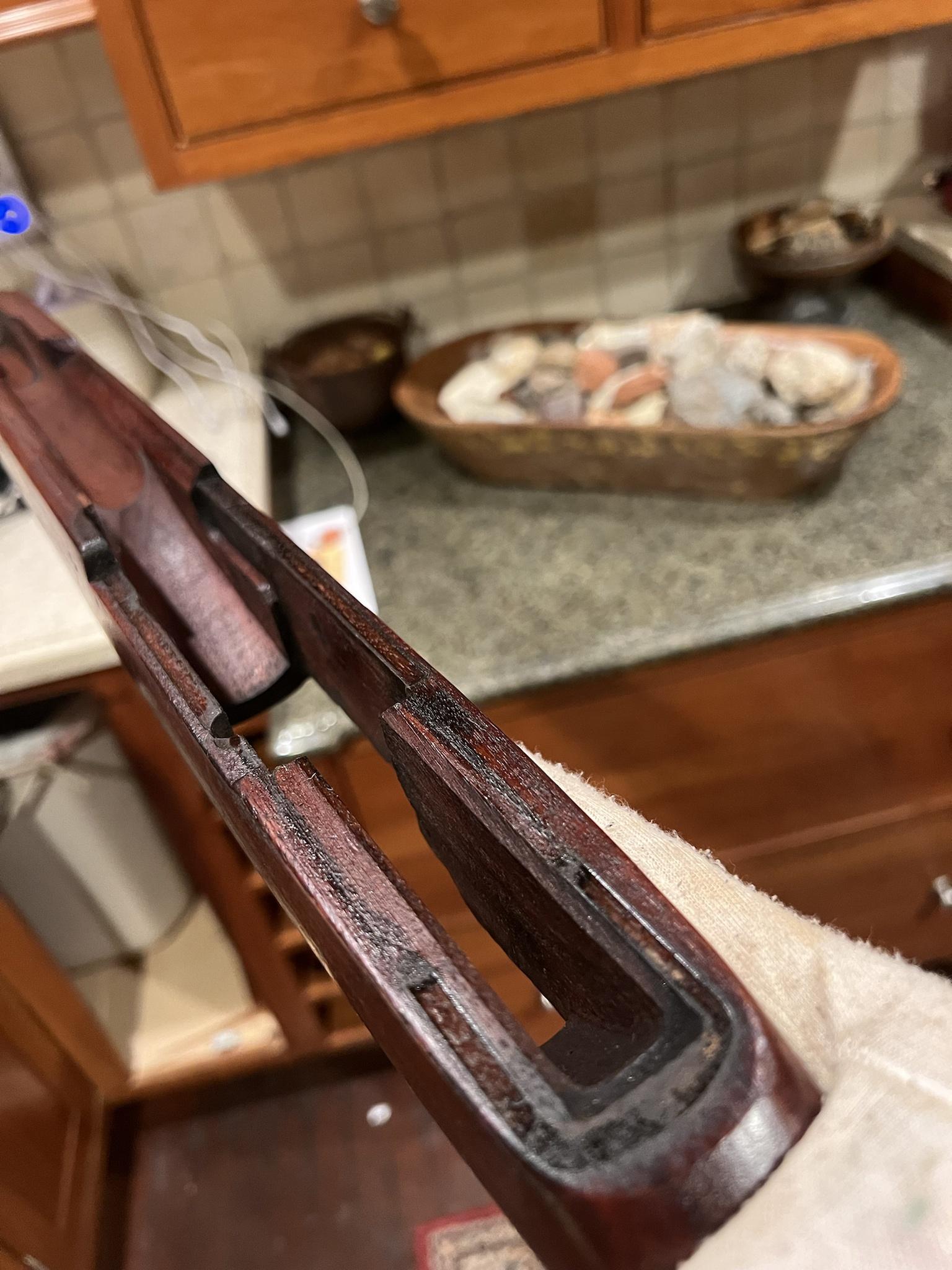

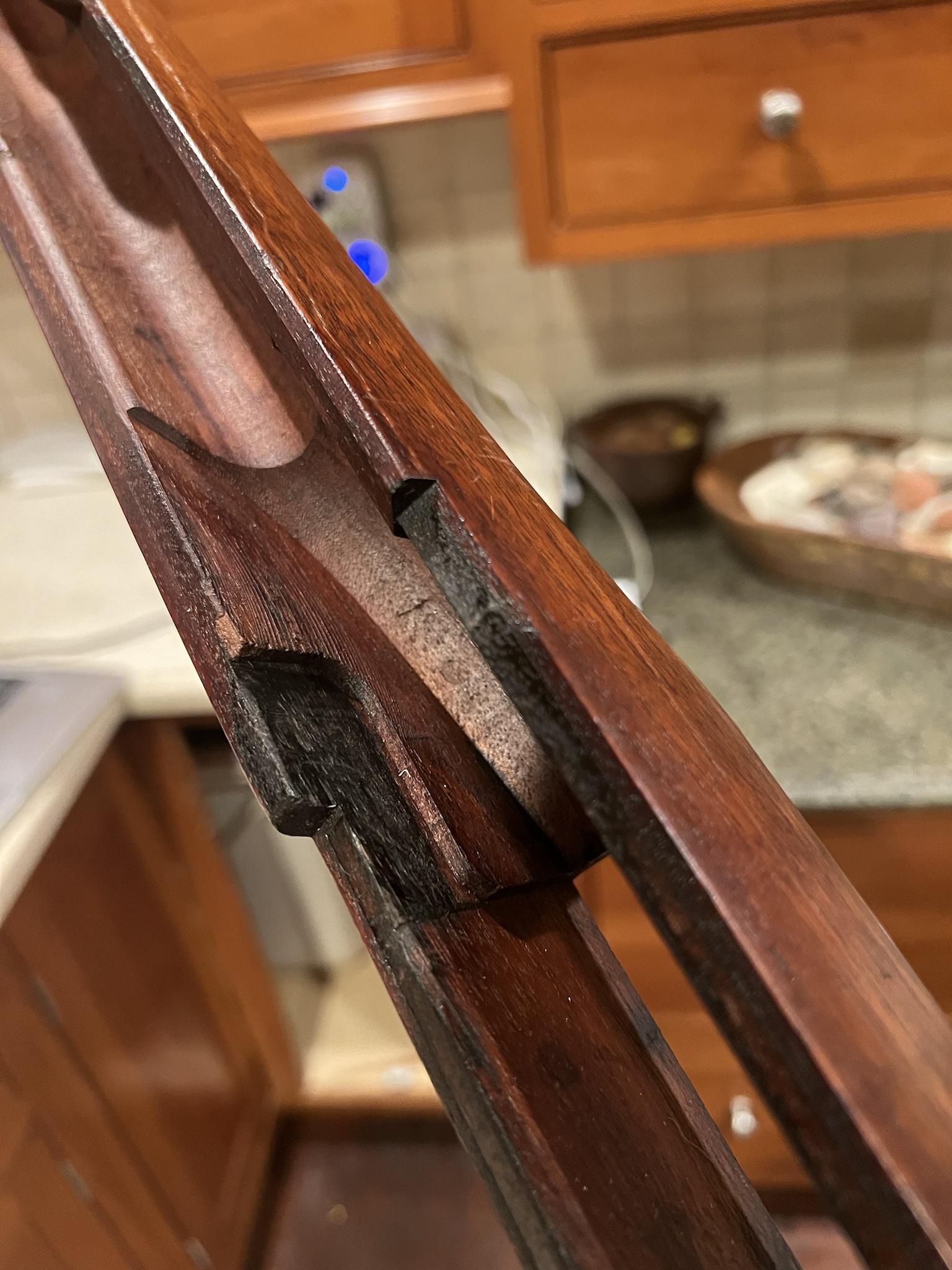

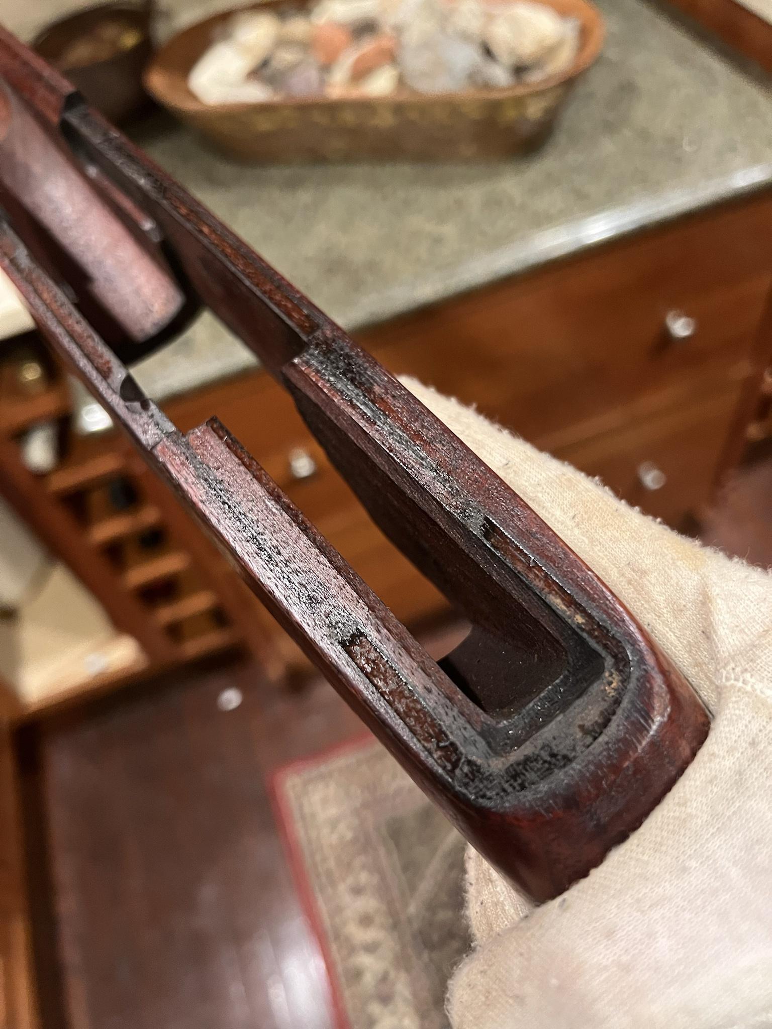

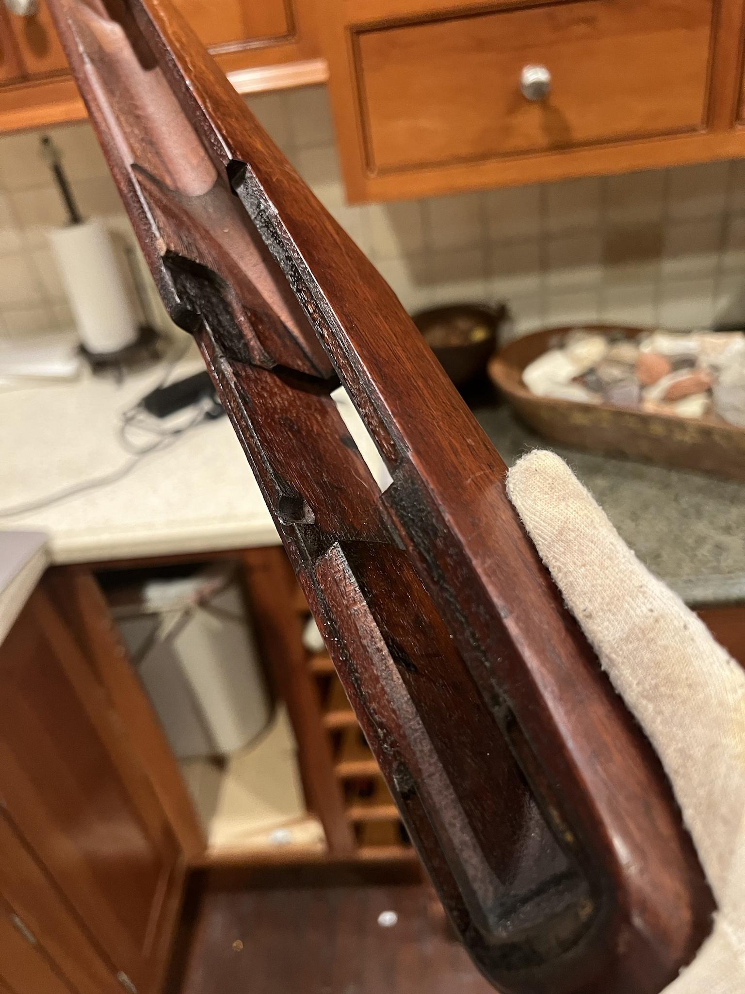

    Short Channel
    Hi Rick,
    It looks to me like a short channel stock with a faint inspection stamp of 97 in the channel.
    There are also spots where the wood has turned black and a tad bit of mold where the receiver sits. I have provided photographs of all these identifying marks. Any idea why those black spots could be?

    The black in pics two, three, four, five are simply oil in the wood. Is that what you refer to?

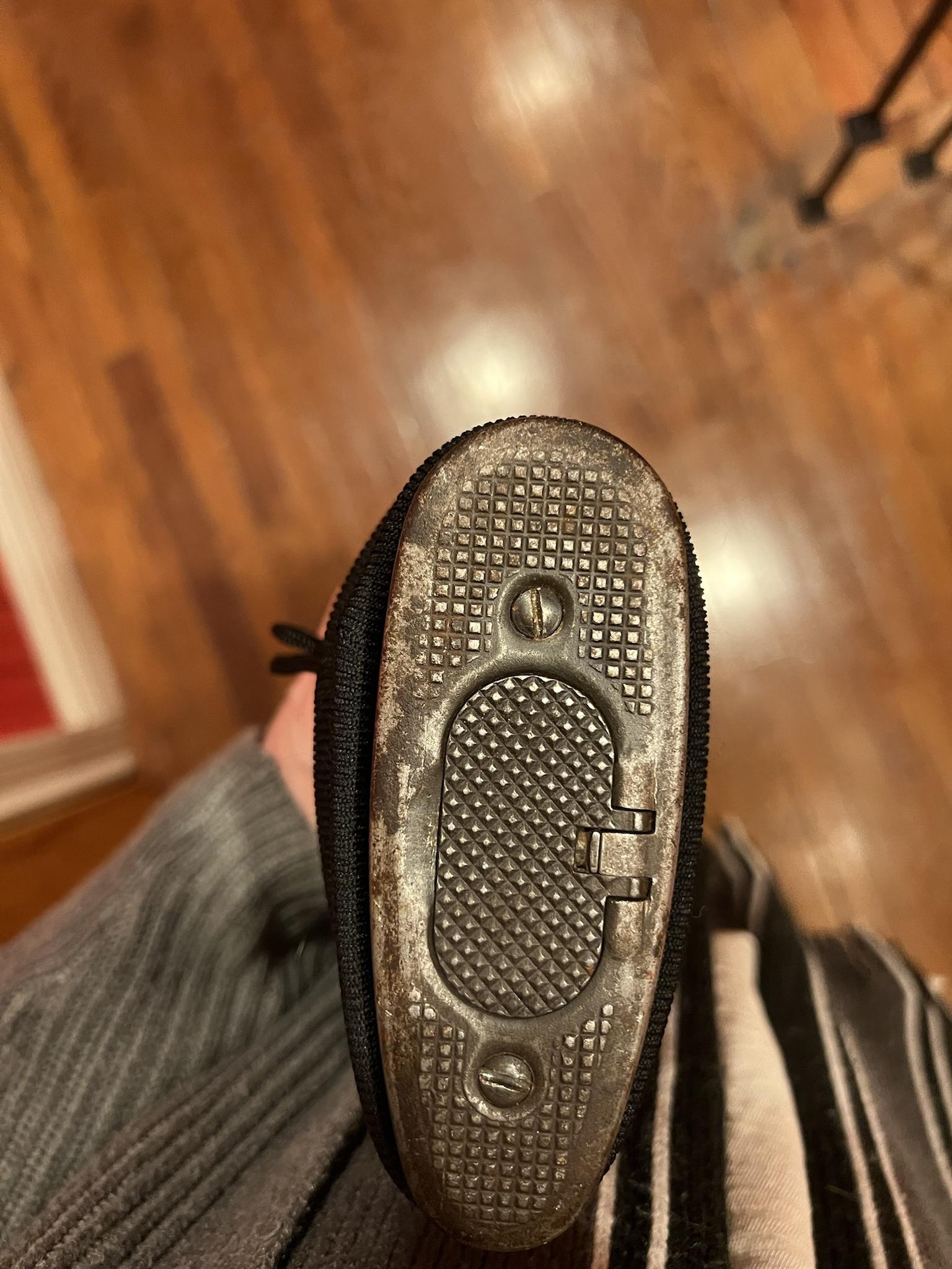

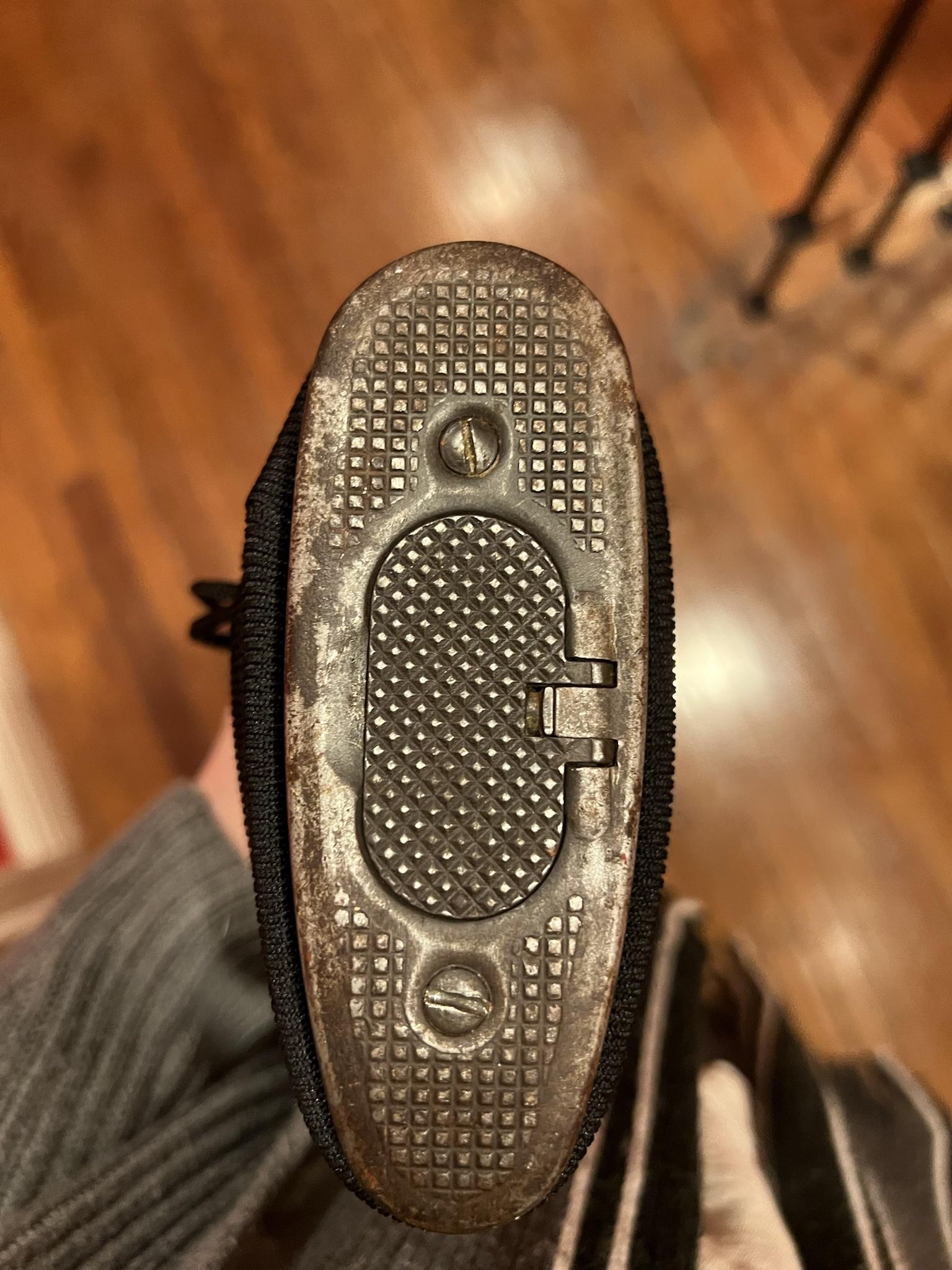

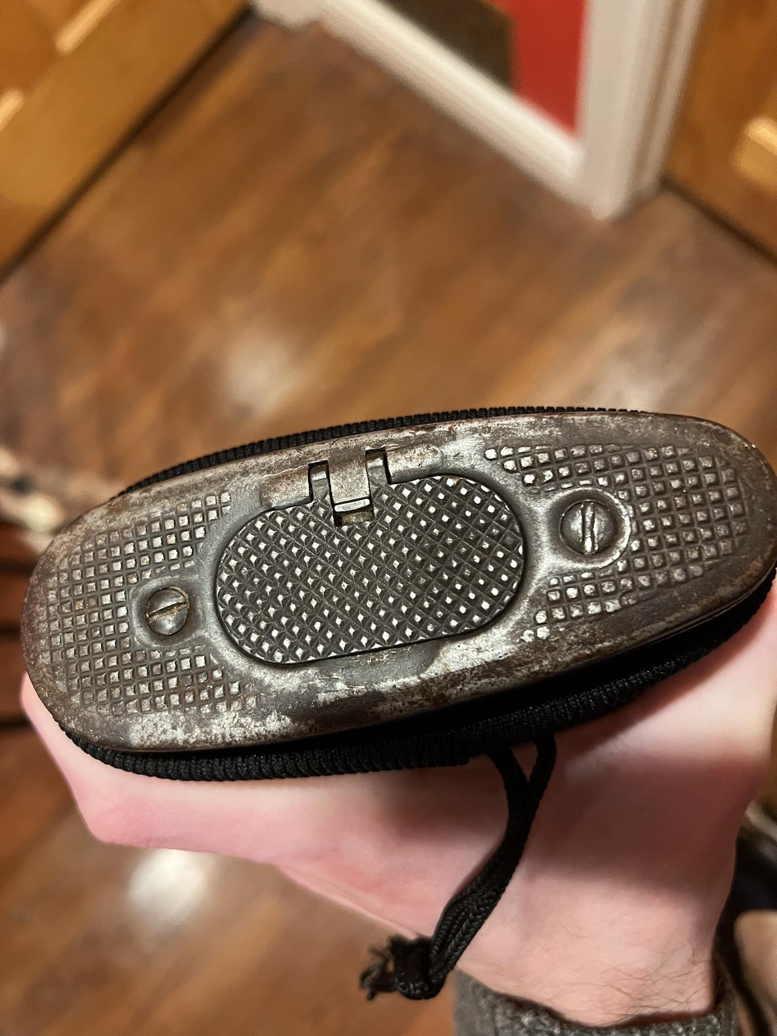

    Hey Rick,
    I'm sorry but I couldn't get the lower screw to budge. The first I was able to get to turn with a larger screw driver, but the lower one refused to dislodge. I'm starting to strip the screw which I'm afraid of.
    I took a few photos of the buttplate; I know this won't reveal what you're looking for but at the moment it is all I can provide. What should I be looking for? I'm not well educated on butt plates other than the 2S marking.

    Thanks for trying. You can leave it as the lower screw is centered making it a Springfield. If it was shifted to the left it would be a Winchester. No need to take it off. Thanks for the pics. Rick Bicon

    Kroil is your friend on Butt screw. Dribble it into sling swivel to get to screw threads.
