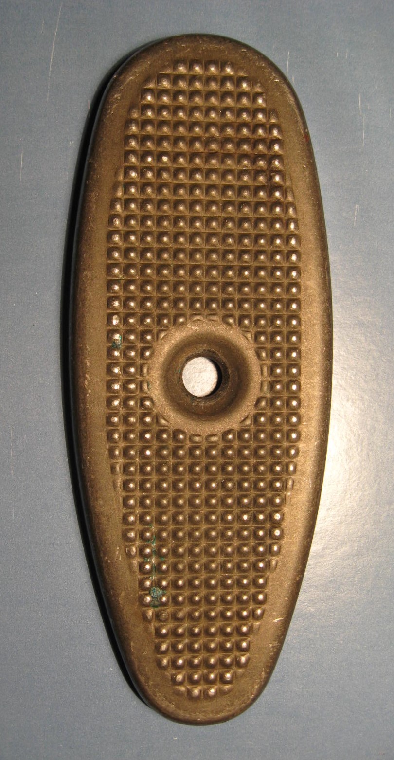

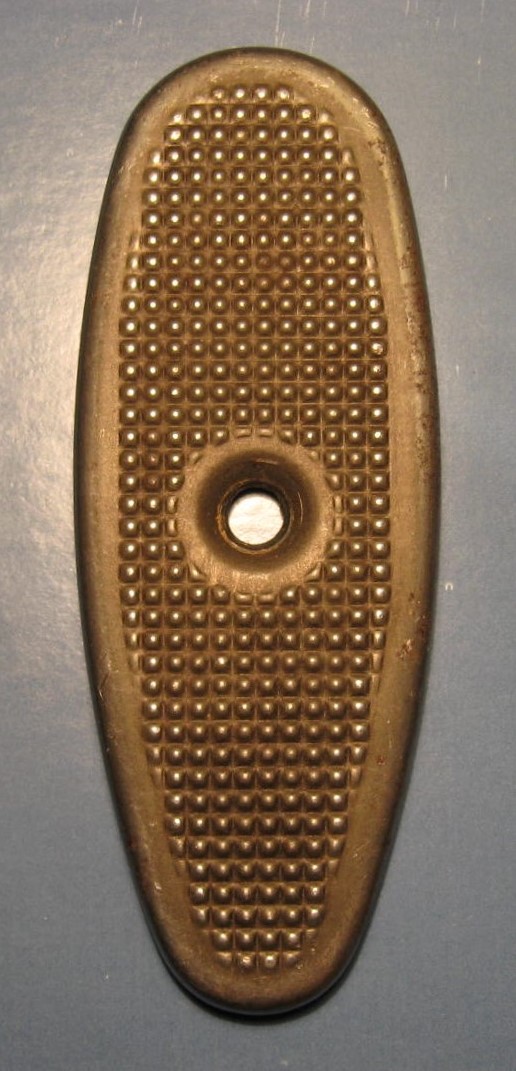

    What's the consensus on the ID of this one? - Bob
    painter777's Avatar
    Central Michigan
    5,326
    05-24-2024
    07:52 AM
    GI Bob,
    I'm leaning towards the WRA plate on the CCC chart, it seems to match up best row by row.
    2nd guess would be the Inland/SG plate that btw I just realized is the same picture... If you look closely at this example at a scratch or dent you'll see it on the other example.

    The butt plate in post #11 is late Inland. You can tell by the gaps at 11 and 2 o'clock.
    Jim Mock's butt plate list is the first time I have seen the three Winchester early, mid and late butt plates shown correctly. Early, dot splatter all around screw, mid, dot splatter only on bottom, and late, no splatter and like a late Inland.
    And part of the confusion with his list of butt plates is because, it does not have the Inland early square pattern, which before everyone removed their original early square pattern butt plate from their original early Inland and replaced it with the diagonal pattern. CC NLs stated, the early Inland square pattern was more common.
    Then Riesch only listed the diagonal pattern for early Inland. So everyone gets guess what happened then. Of course, you can remove the butt plate and see the indentations in the stock wood, if early Inland square or diagonal pattern was original to the stock.
    Thirty years ago, been there, done that, myself. Newbies following Riesch have destroyed many, many original carbines.

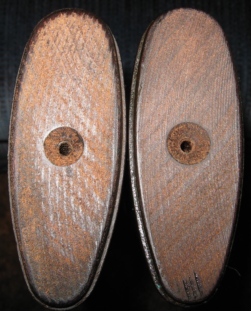

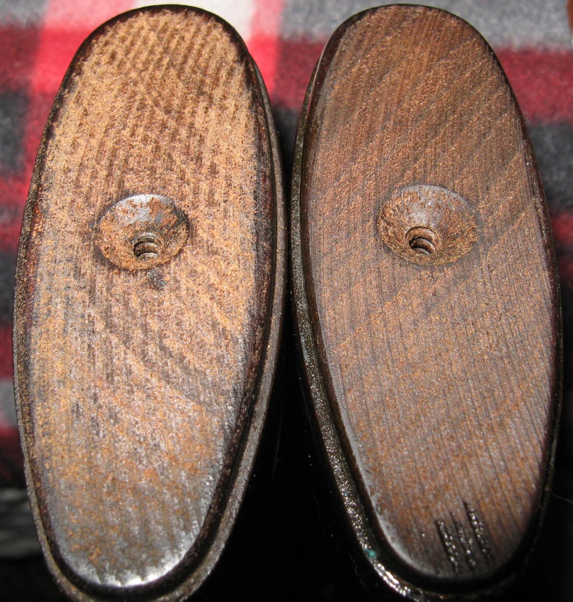

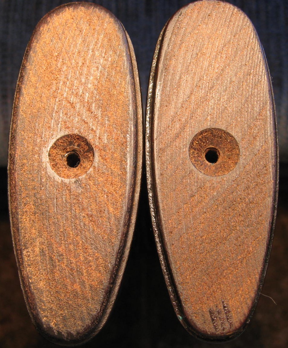

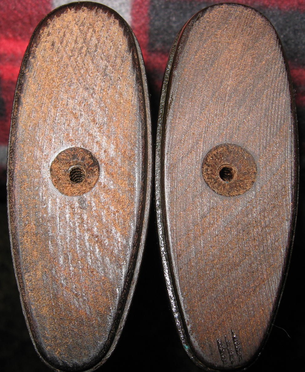

    So GI Bob,
    Just what are you up to?
    The real answer, and I'm not getting much accomplished on it right now, is to determine if the buttplates on my 476K and 408K Inlands are original "square pattern" Inland plates or Winchester. Either I don't understand the CCC site's explanation, or will need to explain to a future owner why they aren't original. I took some pictures today of the stocks they belong to, but can't see meaningful imprints on either one of them. The 476K stock is on the left and the 408K is on the right in all (4) pictures. Only thing I can see for sure is the wood grain and milling marks. I can take higher resolution pictures if you think that would help any, but don't believe there's really anything there to see. - Bob

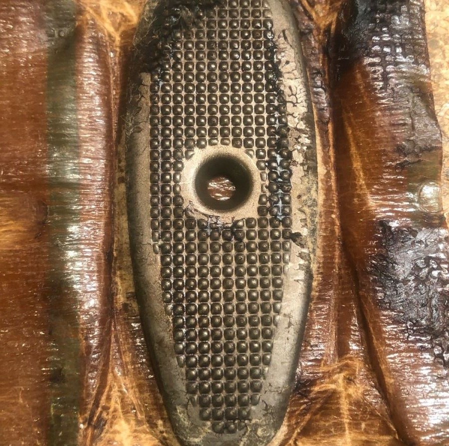

    04:52 AM
    I don't remember where I found these images, but to me it proves that at least some of the "missing-dot" buttplates were made by SA. Hope this helps. - Bob
