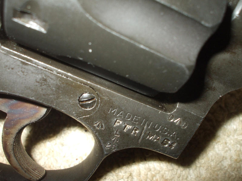

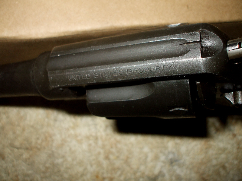

    I have its twin, serial number 688554. It has a Britishicon style lanyard ring instead of the S&W/Colt type on yours. I thought the small proof in front of the trigger guard on the left side of yours and behind the trigger guard on mine are British military but could be wrong. My guess is they were all prewar purchase prior to Lend lease and used in WW2. There were 110,379 purchased by the British starting around sn. 680000 according to the 39th edition, Blue Book of Gun Values
    I also have two of the 5" LL revolvers, one with a Canadianicon ownership mark and the other an Australianicon owned revolver that's Parkerized with post WW2 Aussie FTR markings.

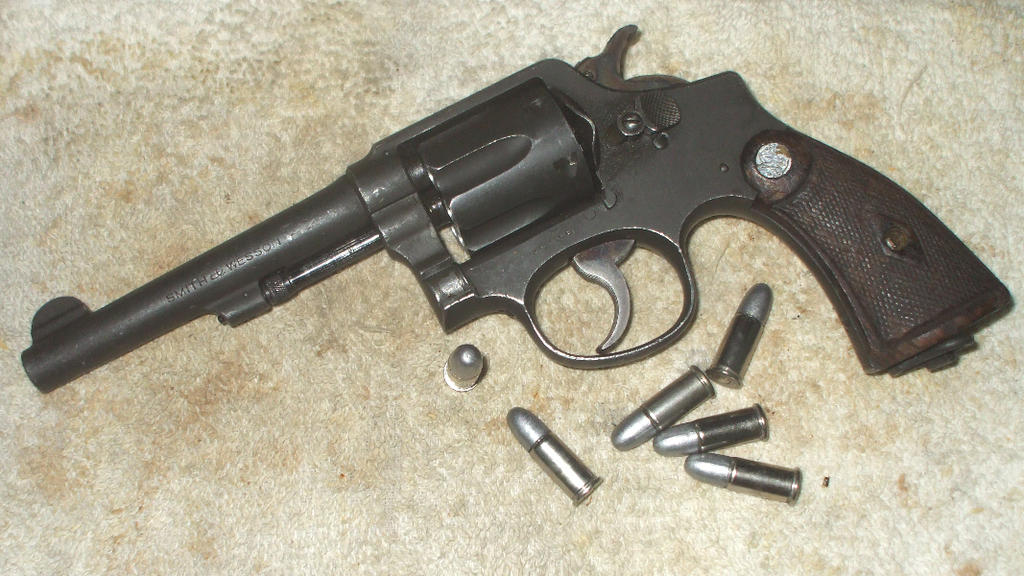

    I also have one of the five inch Lend-Lease revolvers with post war Australian FTR marks. I've sent off to the S&W Historical Society for a letter on this most recent revolver. Here's picture of the Lend-Lease BSR. It is a pretty good shooter with my 38-200 reloads.

    The Australianicon .38-200 revolver I have is also FTR 1954 if memory serves. Parkerized and in excellent condition. Imported to the USAicon post 1986. The Canadianicon revolver is original with lots of finish wear but is still tight and sound.
    Nice shooting. Are you using 174 grain cast bullets? These revolvers shoot low with the usual 145 grain American loads.

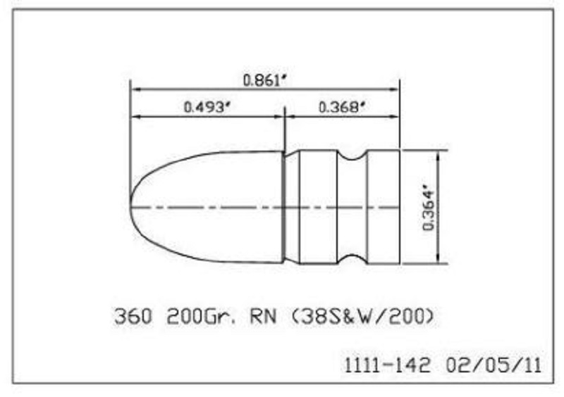

    The load used was a bullet cast from an old NEI #169a mould. 2.0 grains of Bullseye approximates the .380 Mk 1 service load, 200 grain bullet at 650 fps. At 25 yards slow fire it groups pretty well, if a tad high.
    I quite like the bullet. While designed to duplicate the service slug of the Britishicon Empire's 38/200 load, 3.0 grains of Unique gives the same 700 FPS that the old 38 Special 200 grain Super Police loads did. The bullet has more of a secant ogive rather than hemispherical nose of the Lyman 358430. It may be even more likely to yaw. In my opinion, the Brits seemed to have a knack for designing bullets that were nasty or effective, depending on your point of view.
