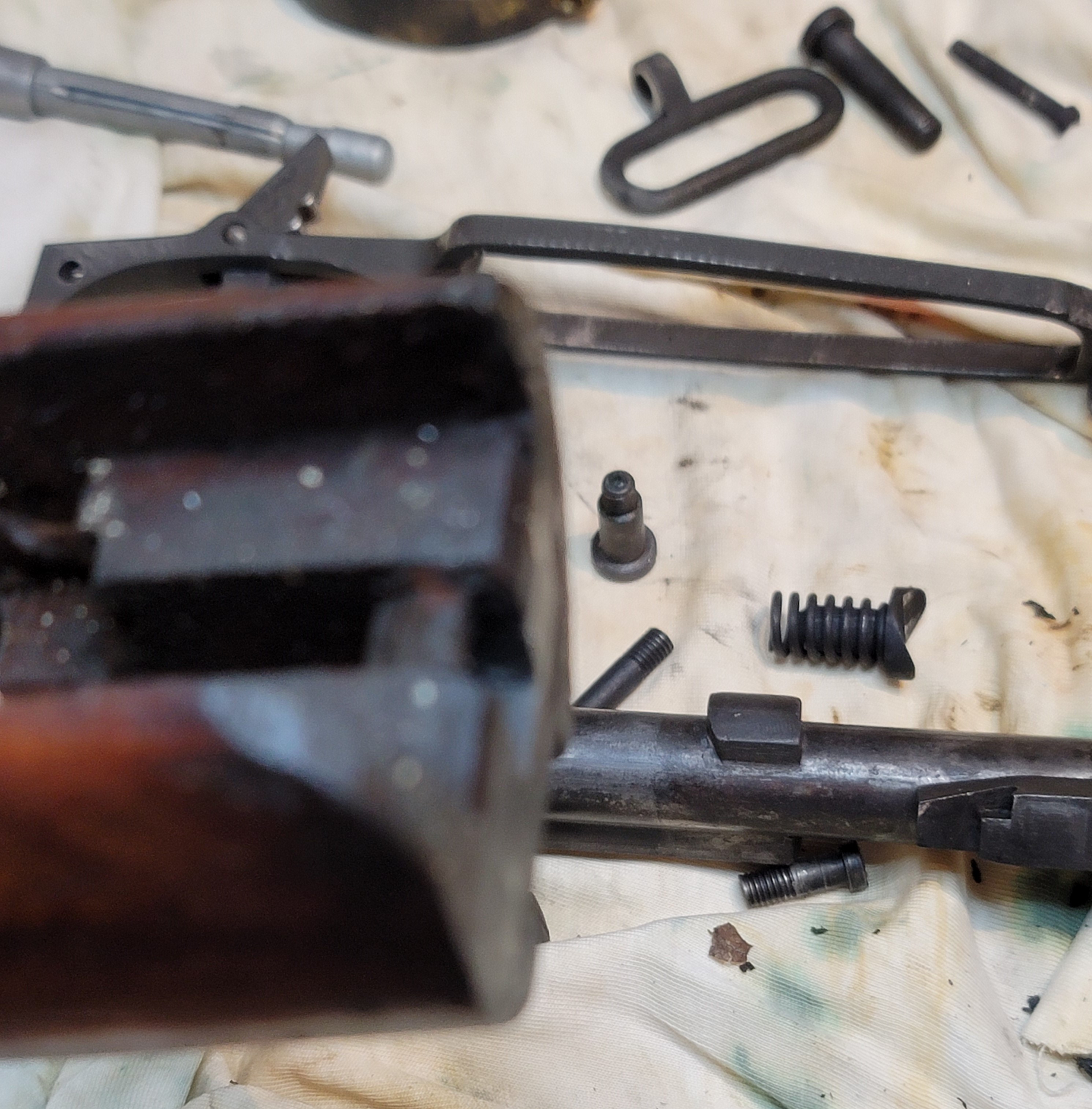

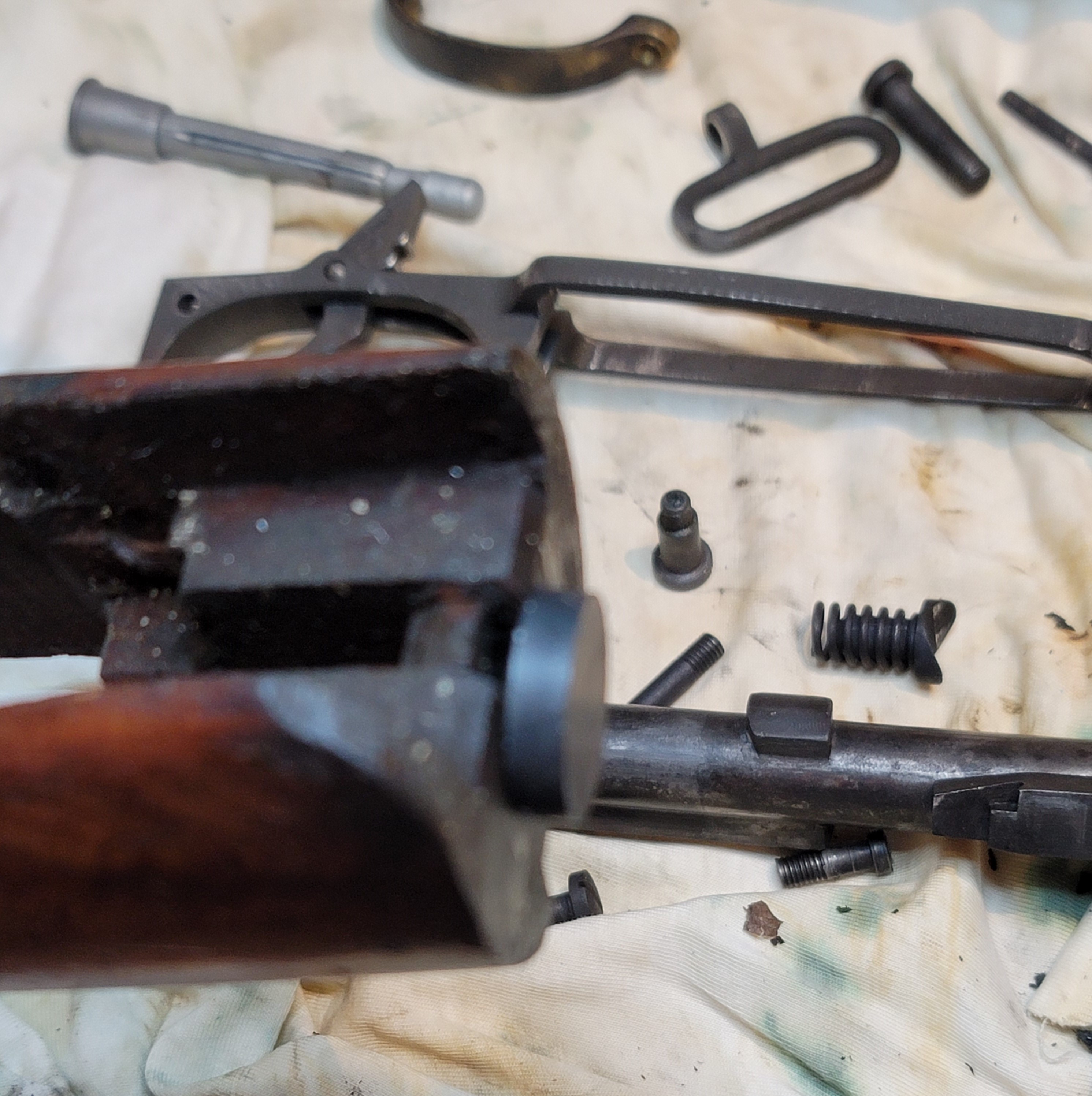

    I'm sure you'll know this already, but before you take the rifle out & shoot it I'd have a good look at that forend - I only have the photo's to look at not the rifle, but it looks to me like the brass tie screw could be missing or broken.
    Than you for that timely advice. Yes, it is missing. I'll by necessity remove the furniture and have a good look at everything. I have a 1921 Lithgowicon No.1 MkIII* that is currently apart as I consider refinishing the wood since someone applied what appears to be a varathane clear gloss finish. The rifle looks like some tarted up Weatherby
    ---------- Post added at 02:53 PM ---------- Previous post was at 02:49 PM ----------
    If the draws are destroyed, patch it with oak and dowels as per Peter Laidlericon's articles posted on this forum. Forget the little copper plates which were a bit of a stopgap measure anyhow for the reasons stated above.
    My Lithgow 1921 No.1 MkIII* is currently apart as I'm removing a gloss finish from the furniture. I checked the draws on it and the metal didn't look like copper so I checked with magnets and they held. Some sort of steel I assume.

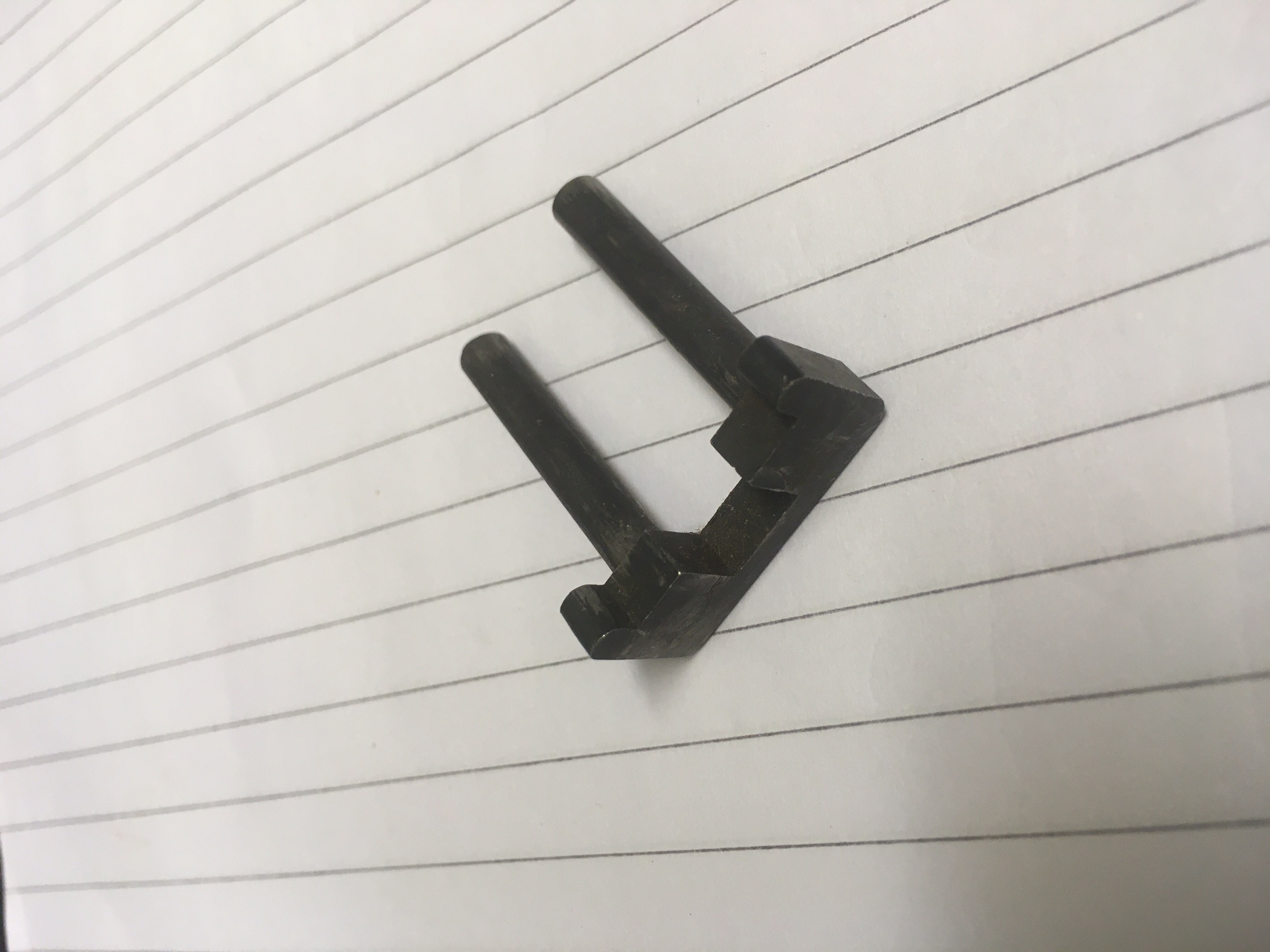

    I've had the enclosed so long I can't remember where it came from, but I think I was told it was tried as an alternative to the copper plates, & was an Aussie invention. However, I've no idea if that is true or if the two forward projections actually did anything useful.
    It's been in a drawer for the last thirty years.......

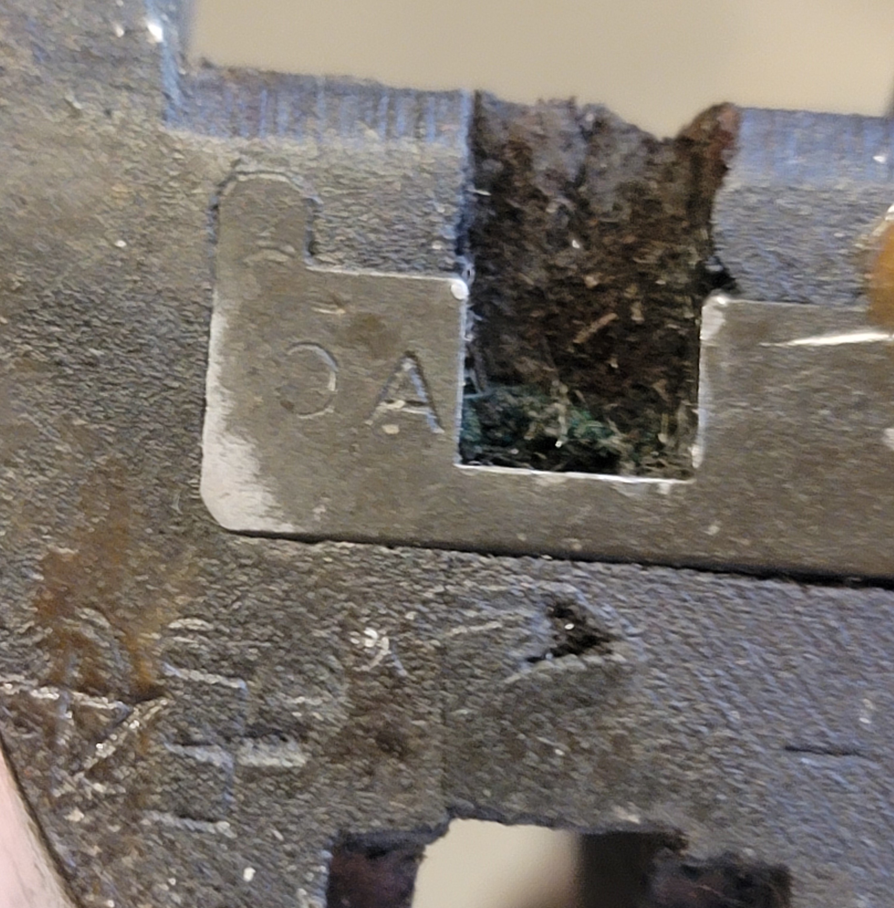

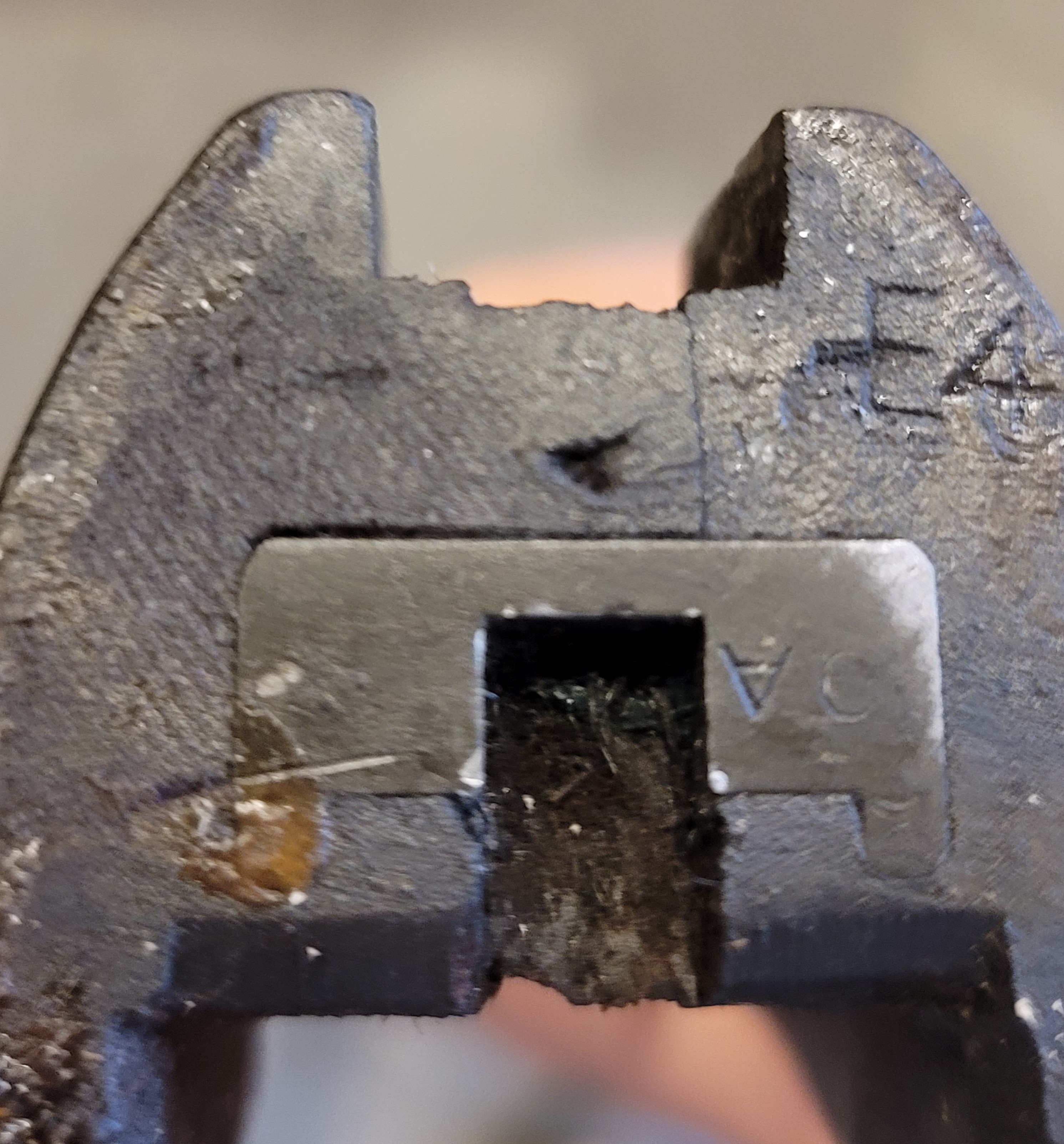

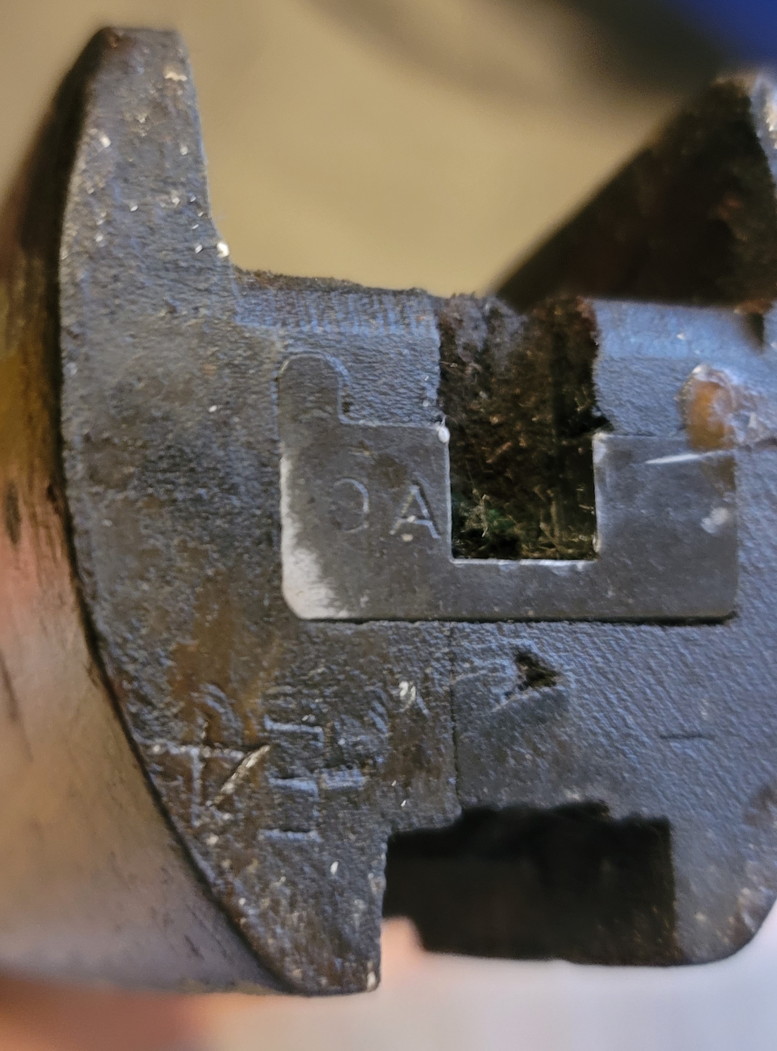

    OA manufactured
    I believe that was used to repair fore ends that had cracked at the butt socket end. Take a look at my fore end, it has an OA stamped steel insert which appears to be used to hold the cracked fore end tight together.

    Thanks for that, & sorry, I may not have explained myself clearly. The U shaped steel plate is a standard fitment to SMLE forends (apart from late produced Indian patterns) - it is the two forward projecting steel rods that make it a little unusual. It looks as though they would project forward into the draws..........

    There is a fine crack on the left (# 1, 2, 3) pretty sure that screw wire can be used to ensure no more propagation of it.
    P.Laidlericon or Brian Dickicon may be the best ones to assist you with getting that fixed if your retaining the wood.

    That vertical crack at the back end is permissible according to the EMERs. I've glued many after a good degreasing over the years but imaging they just open up again.
