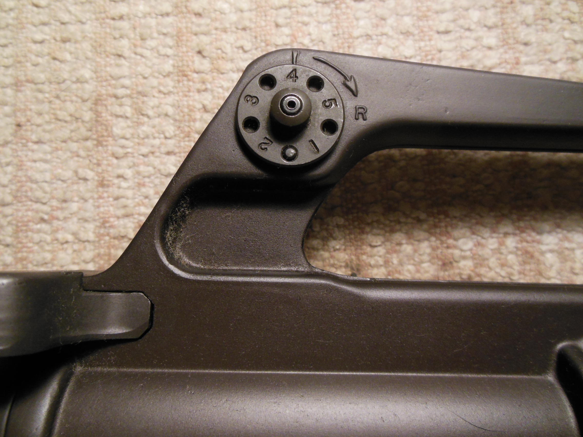

    Found a correct Windage Drum for a 601 from AR15SPORT.Com - perfect replacement. Also realized the original cast 601 FSB with raised direction arrow was replaced with FSB with stamped direction arrow. It might be a challenge to find the earlier one but will try. If there's one out there the holes may not mate up with the barrel grooves...not sure.

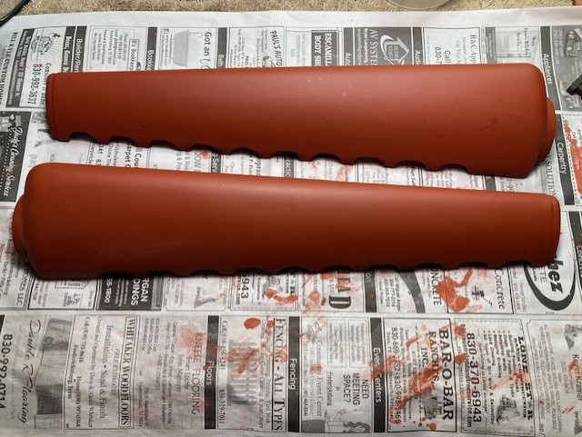

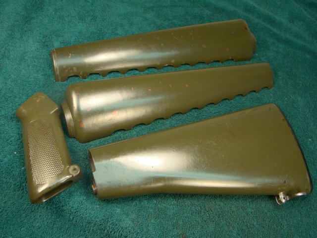

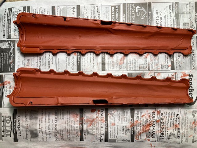

    The 601 handguards have been sanded and sprayed with three light coats of Duplicolor Red Sandable Primer/Filler. A few more coats and sanding scratches and light blemishes should all but be unnoticed after final finishing with the green paint. After internet research it appears the correct green finish was probably FSN 34151 ANA 611 "Interior Green".

    Quote Originally Posted by Madcap View Post
    "Interior Green".
    Whatever it is that looks close. I had a set that came on a test rifle, fibrite brown butt and handguards. They had been painted green and then black. Hardest coating to remove, to get back to the fibrite brown.
