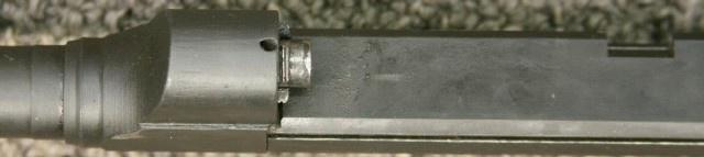

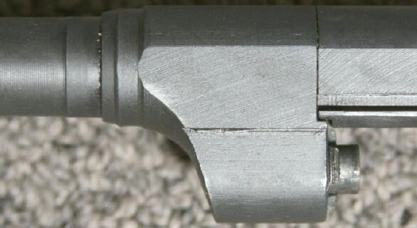

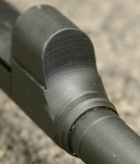

    I'm thinking maybe it is an ERMA barrel, maybe recently re-crowned. The SG has the purple trigger housing indicating possible German/Austrian use, and it has the distinctive collar in front of the gas block. According to M1icon Carbines Inc. (see link) these barrels are found unmarked on some of these Ger/Aus Carbines, and they are the only ones with the distinctive collar. First three pics are Erma and show a bit of variation in the collar. Criterion and Green Mountain do not have the collar, at least in the pics I have seen. As for the SG being in a birch pot belly, that may have been switched out by my friend to have an M2 stock.
    U.S. Carbines in Germany and Austria
    My barrel:
    Open to all opinions. The key, of course, is how does it shoot. That'sall that really matters to me!
