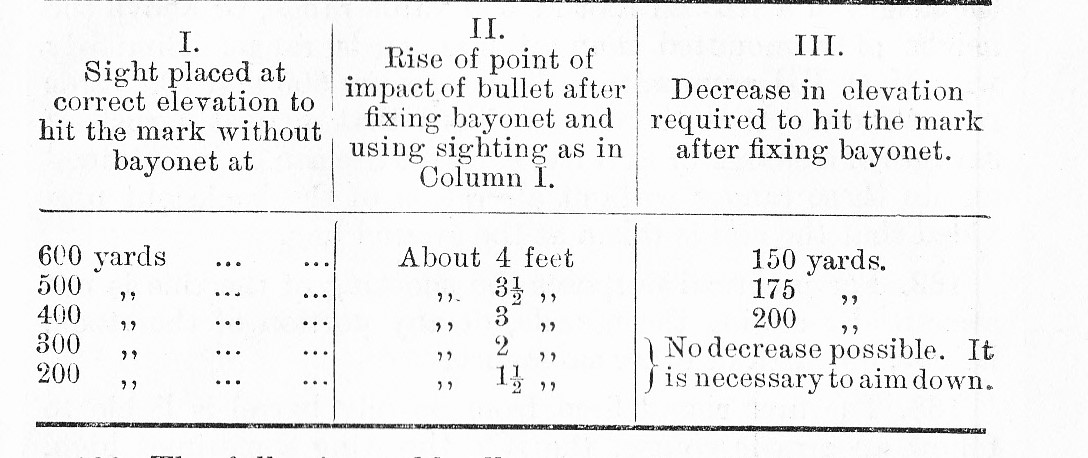

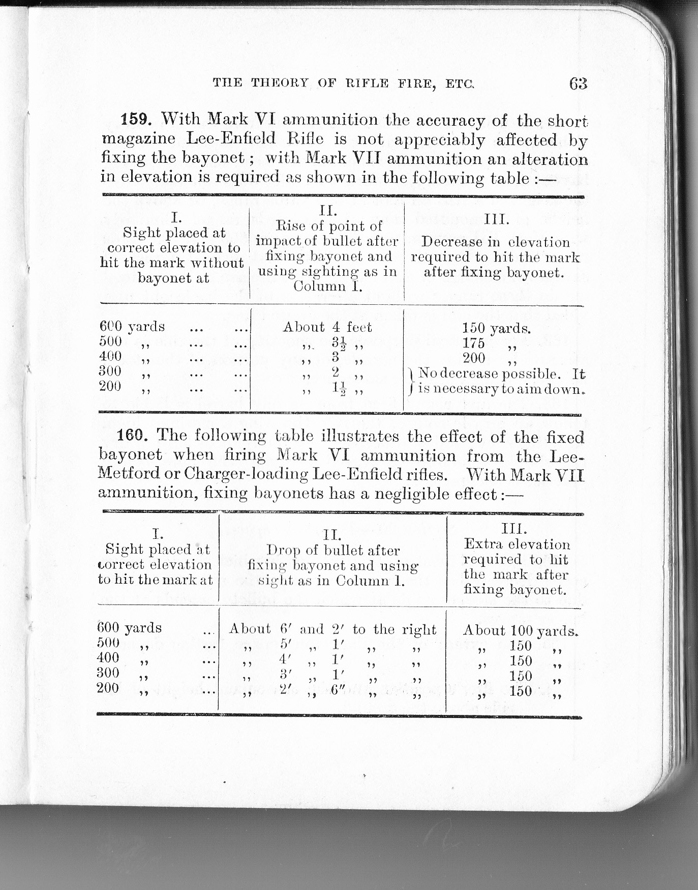

    Quote Originally Posted by Neuraleanus View Post
    My No. 1, Mk III rifle tends to shoot high at 100 yards. It is my understanding that the presence of a bayonet affects the height accuracy.
    Unless you are using MKVI or MKVII ammunition the following will be of no use to you.
    Fitting a bayonet onto a SMLE and using MKVII ammunition results in an increase in height of the POI
    Source :
    “Musketry Regulations Part 1”
    1909 (With Amendments 1914)
    Issued by the General Staff – War Office.
    Summary :
    With a SMLE & with MkVI ammunition there is no effect to the POI when the bayonet is fixed.
    With a SMLE & with MkVII ammunition there is a 4 feet Rise in POI at 600 yds when the bayonet is fixed.
    With a Lee Metford, or CLLE there is a 6 feet drop, and 2 feet to the right change in the POI at 600 yds when using MkVI ammunition with the bayonet fixed.
    With a Lee Metford, or CLLE there is a negligible effect in the POI when using MkVII ammunition with the bayonet fixed.
    YES – that is correct – with the CLLE / Lee Metford the POI is NOT AFFECTED when using MkVII with the bayonet fixed, but with the SMLE the POI is NOT AFFECTED when using MkVI with the bayonet fixed..
Name:	Effect of Bayonet MKVII ammunition.jpg‎
ID:	139034   Click image for larger version
Name:	Effect of Bayonet on SMLE_0001 (2).jpg‎
