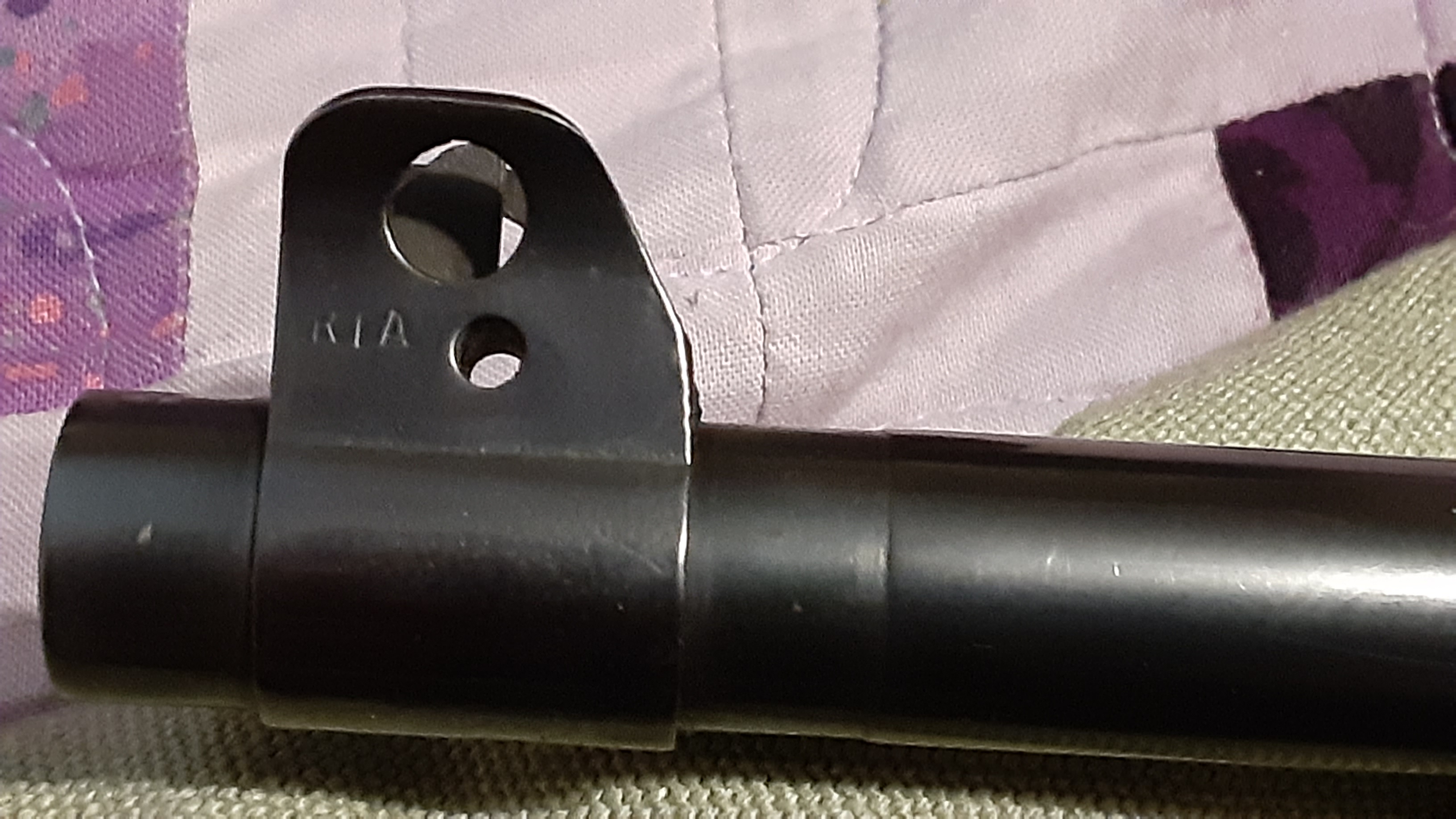

    The markings on the barrel flat make it Inland, Gas Cylinder I-I is Inland made and I believe thru the carbon I can see 2 letters on the end of your gas piston, so that would be a Sub made part for Inland. The rest of the barrel shows no milling grooves. So likely polished away with the Inland name and date. Then the obvious refinish like many were in the 60's to look 'Pimpy'.
    You catch what we mean by the late serial number right? Made to go fast when you wanted it to.

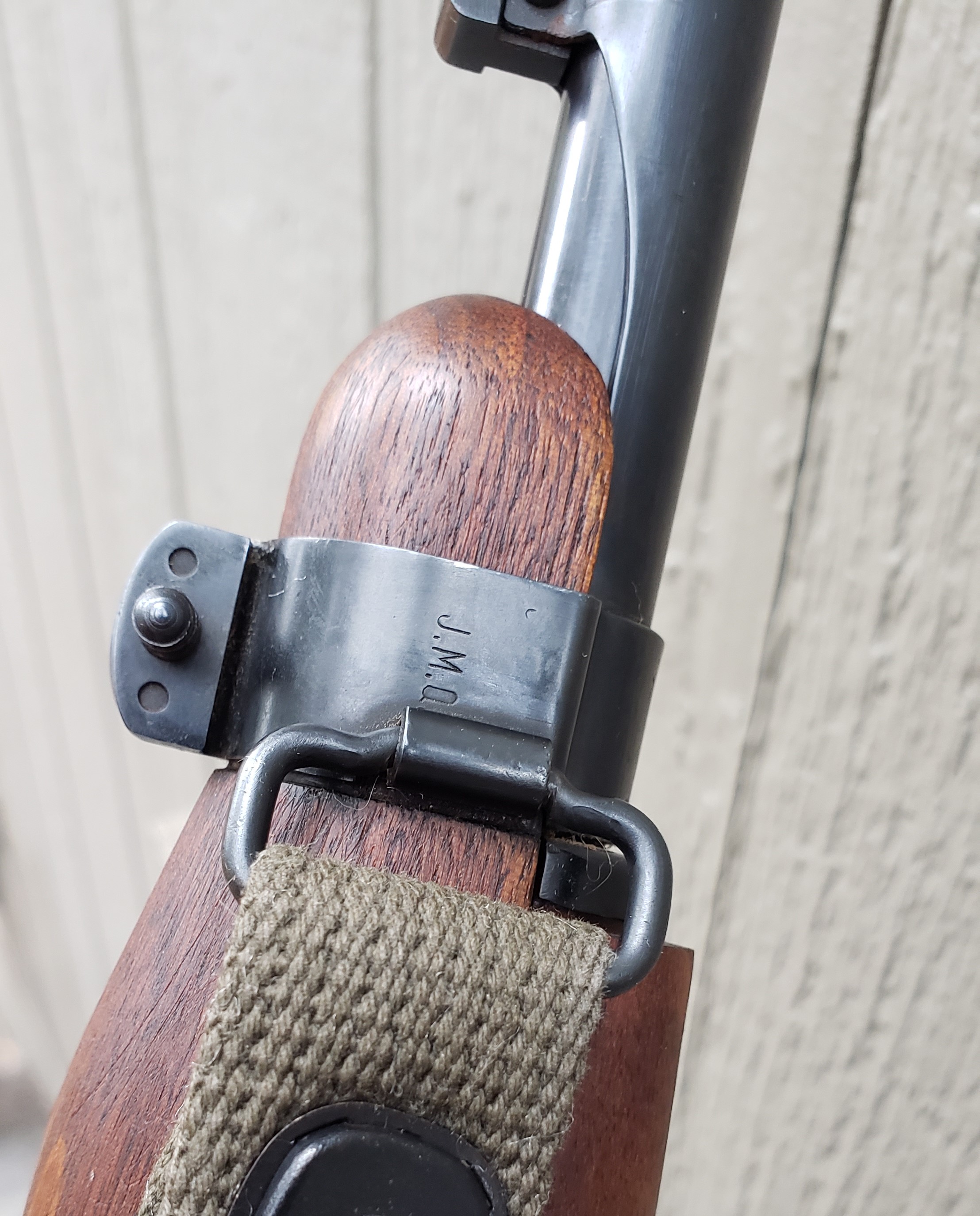

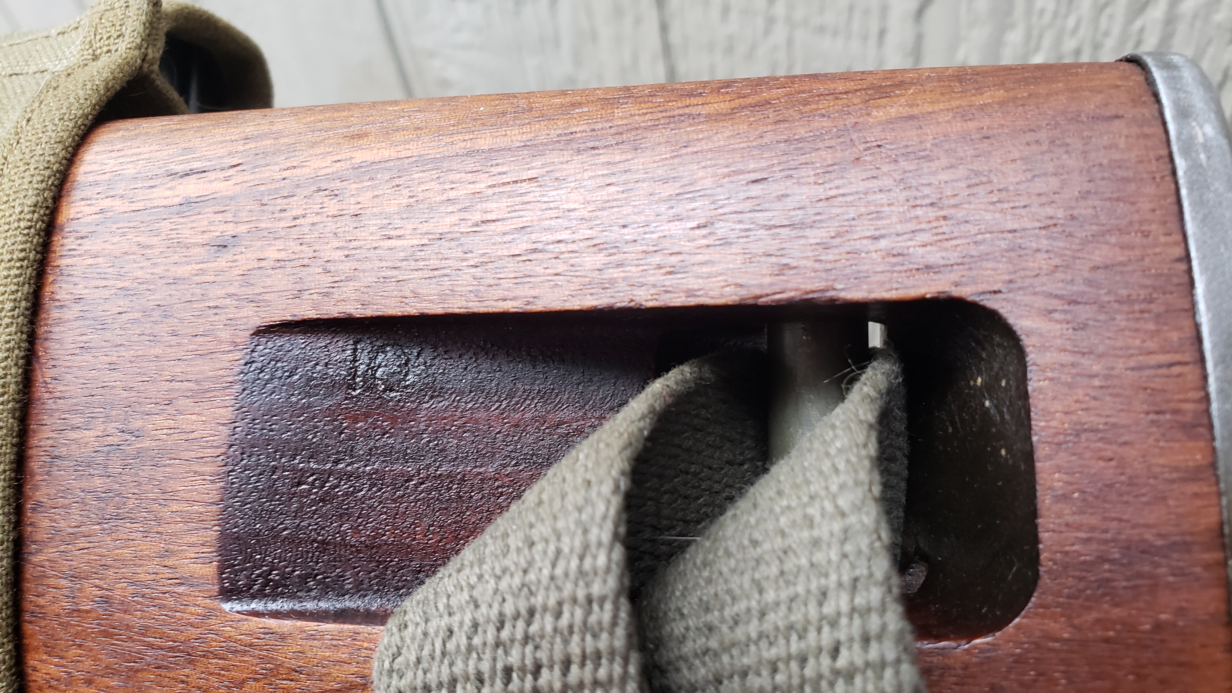

    I think it's a good looking Carbine. Is the stock marked in the slingwell?
    I sent you a PM with a Link.
    You should give us a idea of what parts and markings are in it as you clean the Grime off!

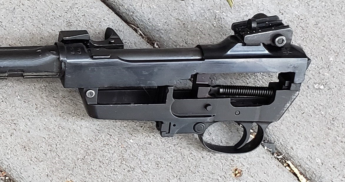

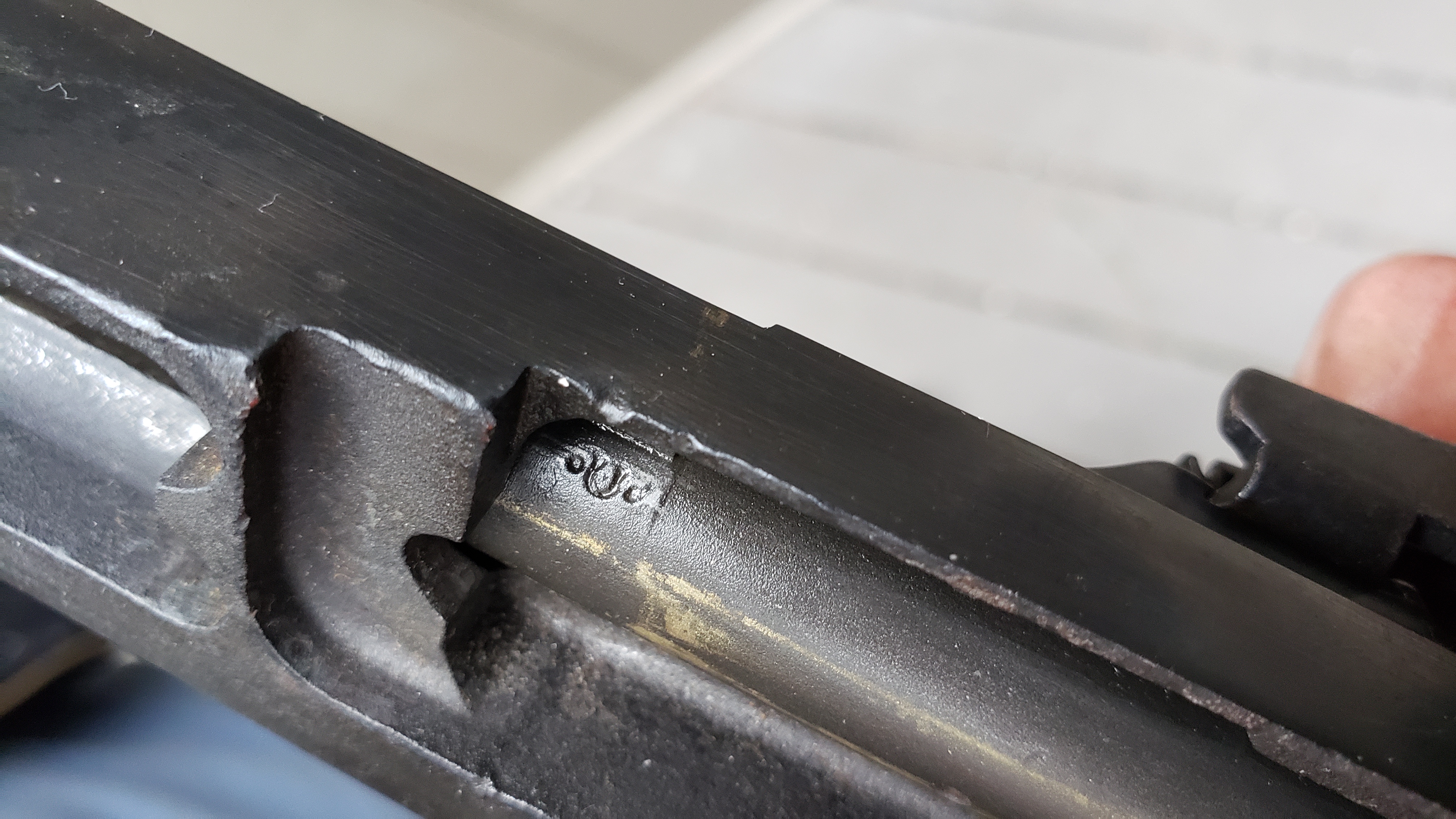

    Haha, ok ok, deep cleaning underway... That piston was clean before I ran a few rounds through it a couple of weeks ago! It sure got grimy fast. Here's a few more pics BEFORE I cleaned anything. The barrel is always spotless though! Shiny and rifling looks really sharp.

Name:	M1 75525XX stock sling stamp.jpg‎

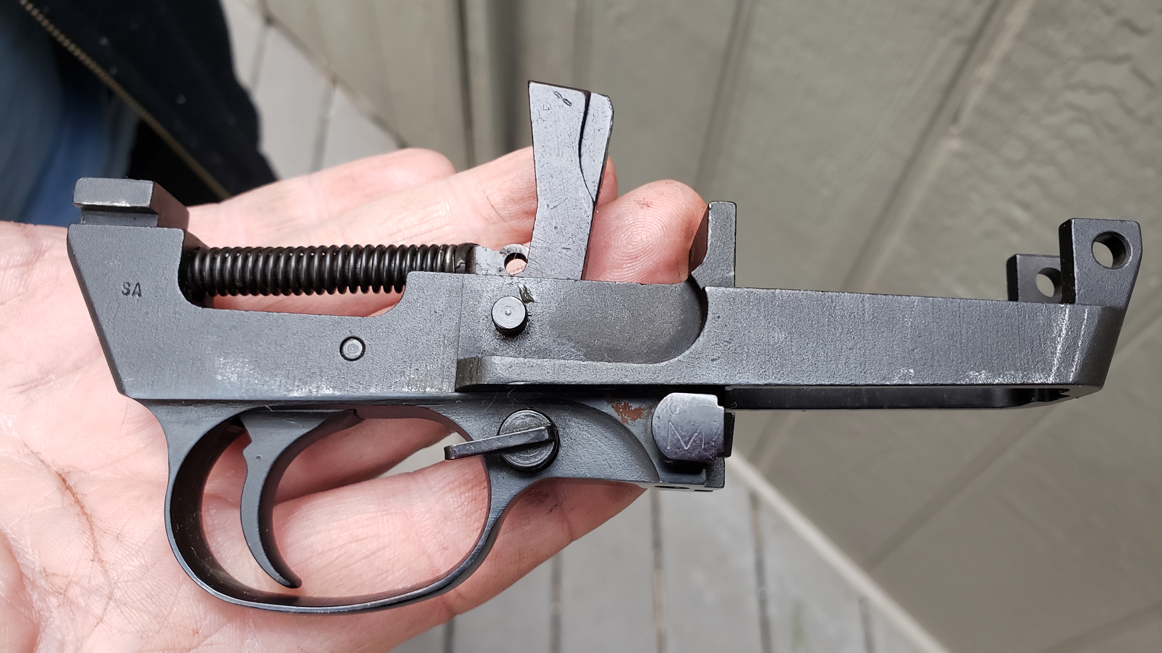

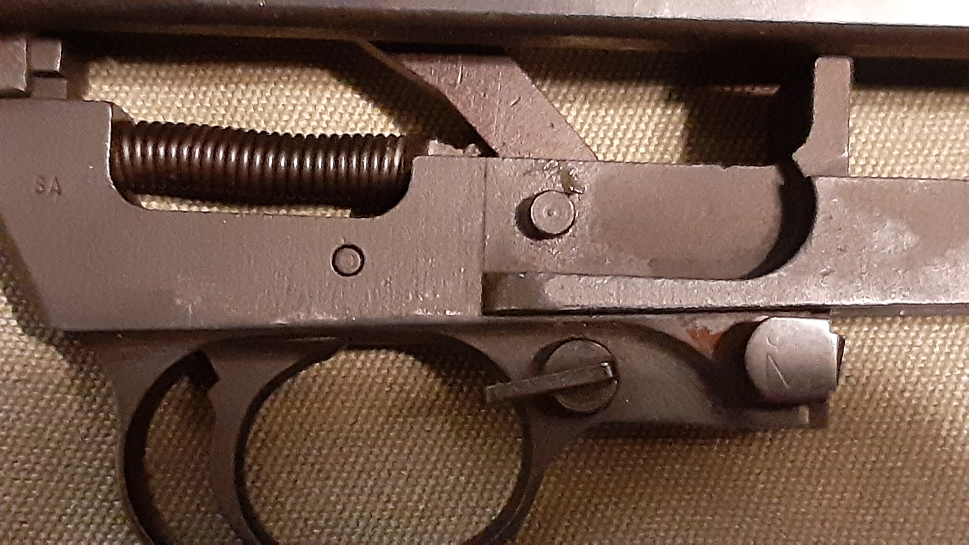

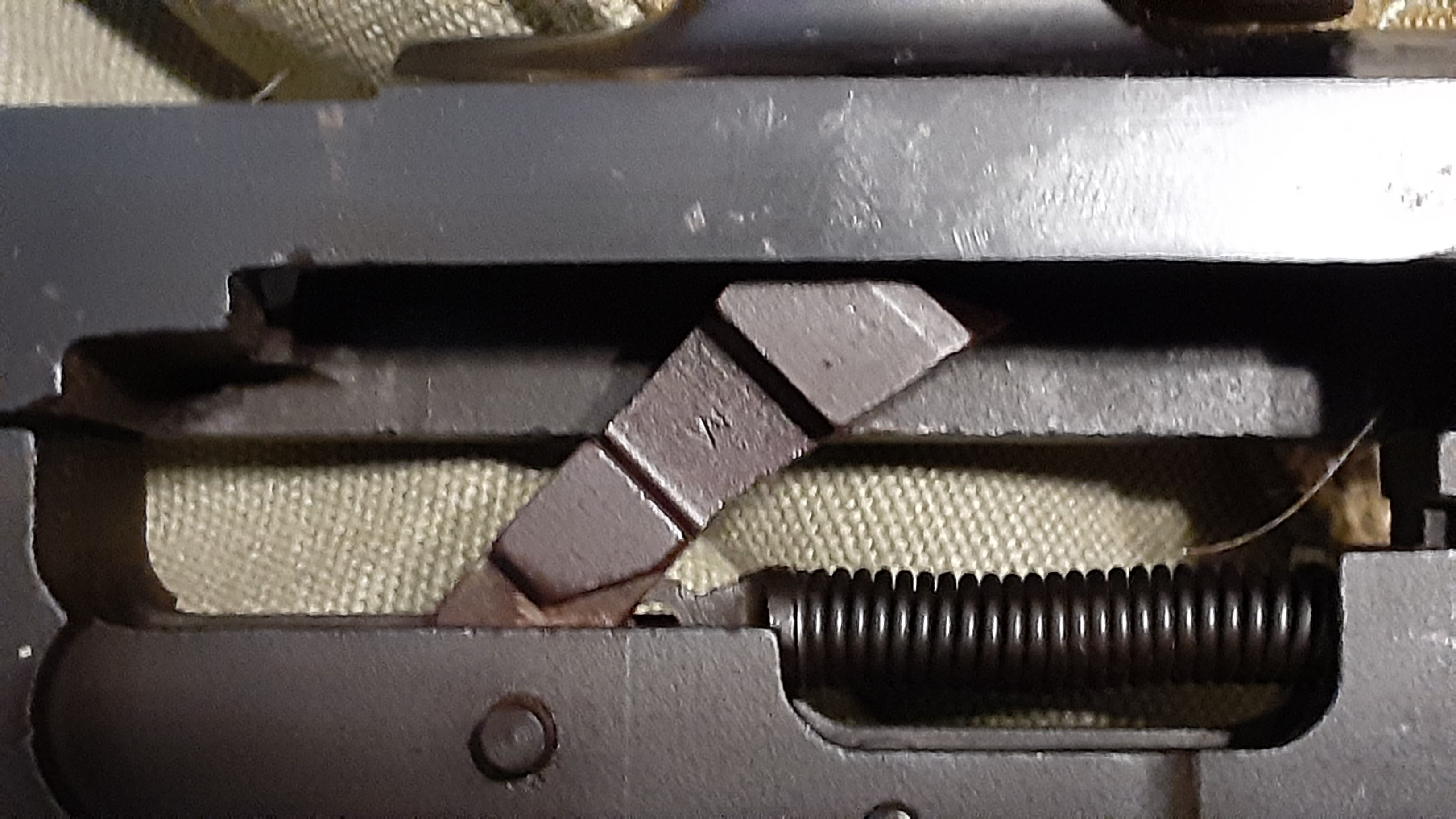

    Your trigger housing is an M2 variant. Nothing at all wrong with that just pointing it out in case you didn't know

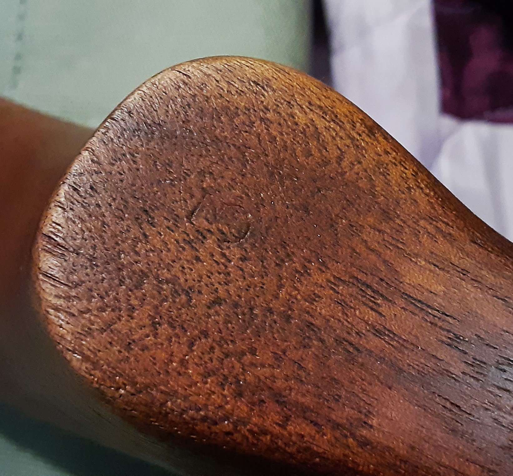

    It is really smooth and accurate. The new op slide/spring/guide make it usable again. Also cleaning the bolt and some new springs probably helped a lot. No feed or extraction issues at all so far! This one was the black sheep, so I can relate and I like it plenty. Carbines are just really fun to shoot, esp. when your op slide isn't jumping around
    I've learned more about this carbine in the last couple of days than we've been able to find out in decades, thanks you guys.
    Looks like the stock is Inland, but the only other stamp is that 3 on the bottom of the grip. Maybe it was "finished" like the action was, and they got sanded off.

    03:10 AM
    Indeed. Upon further inspection, looks like a type VI...
