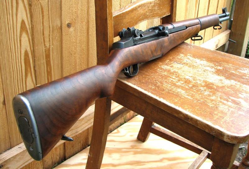

    Dean's Gun Restorations uses a product called "Deft Danishicon Oil Finish." The Deft site describes it as a "penetrating tung oil urethane Danish oil finish," whatever that is. I can tell you that it is gorgeous in person.
    The Lowe's near my house has the Deft product. Hmmm....

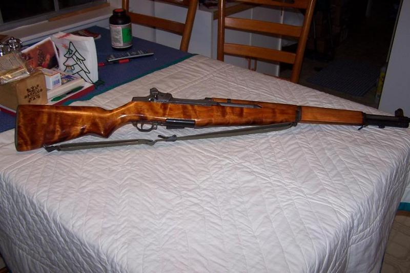

    Okay, you twisted my arm. Here's a pic:
  7. #16
    hpcomp's Avatar
    04-01-2010 @ 07:43 PM
    5
    07-06-2025
    10:15 AM
    That is exactly the appearance I am after.Thanks to all that responded.

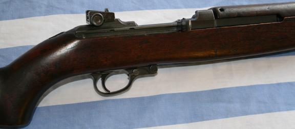

    Mine, with Varathane polyurethane...

    11:15 AM
    I refinished two stocks stripping them completely and used Fiebings dark brown shoe dye. Messy job, but the color turned out beautiful. a deep reddish brown color. Wipe off the excess and let thoroughly dry. Sand and repeat. I used tung oil to finish, leaving the tung oil finish glossy inside of the stock, and polished dull with steel wool on the outside. Sand or steel wool between coats. Make sure you build up enough coats of tung oil to seal the dye or it will be on your hands after shooting. Three or four heavy coats is sufficient, or more thin coats. I tested different methods on a block of walnut before I tried it to see if I liked it. A lighter colored dense grain will not get too dark, and it will show the wood and any variations very nicely after you wipe off the excess dye. This carbine stock was terrible, and I stripped and refinished with dye.
    Another easier way I have done stocks with success is using minwax stain. Their stains come in a great deal of colors, and they also seal the wood. I let thoroughly dry and then use a beeswax mix like you have. I melt it in with a heat gun and wipe off the excess. You can reapply the wax anytime.
    Good luck
