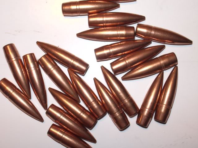

    The bullets below are a perfect example, steel core Russianicon pulls, .310 diameter boat tails, in a worn barrel they have “blow by” and want to go any direction but straight.
    These same bullets shoot fine in a like new Enfield barrel but put them in a worn two groove barrel and they start shooting sideways.
