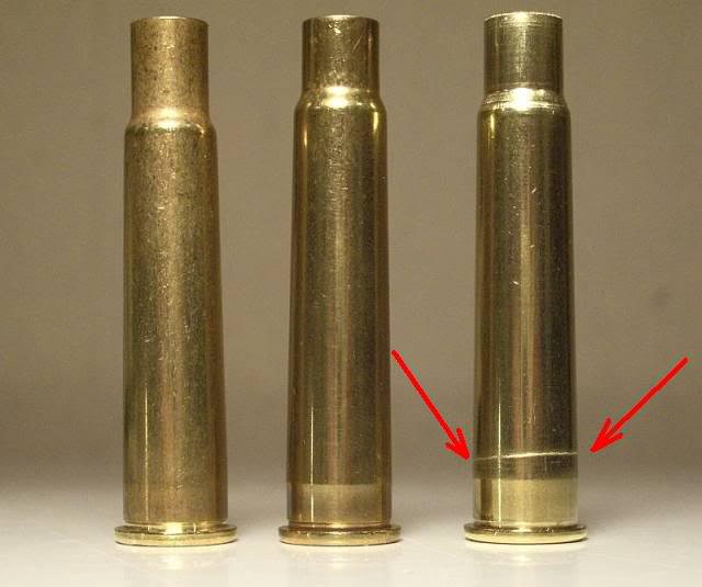

    A new modern commercial rifle has 3 to 6 thousandths head gap clearance or "air space" between the rear of the case and the bolt face. A Enfield Rifleicon at the maximum head space setting of .074 and a cartridge with a rim thickness of .058 can have .017 "air gap" between the rear of the case and the bolt face.
    This means the base web area of the case when fired can stretch as much as .017 (seventeen thousandths) this weakens the case and causes case head separations and short case life when reloaded.
    Below is an example of case thinning and stretching in the base web area.
    With the rubber o-ring around the rim of the case, the case is forced against the bolt face and the case does not stretched when fired.
    The rubber o-ring also compresses and centers the rear of the case in the chamber helping increase accuracy when the case is reloaded.
    The rubber o-ring doesn't care what the head space is set at or your Enfield or even if the head space is larger than the maximum setting of .074 within reason. After the case is fire formed you neck size only and the case will head space on the shoulder of the case and not the rim.
    Your are "fooling" the case into thinking it was fired in a tightly head spaced Enfield or "fooling" the rifle into thinking the rim of the case is much thicker. The end result is no case stretching in the web area and cases you can reload many more times before case failure.
    Below is a factory loaded Winchester case fired in an Enfield with the head space set at .067. The case stretched .009 thousandths when fired without an o-ring.
