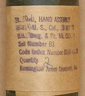

    This post has nothing to do with the Remington Hand Guards used on the production of rifles, but I figured it would add to the information out there.
    There are different Remington hand guards, but from what I have been told from the advanced collectors, these were never used on the rifle production. I do not know that based upon my research, as I am not a rifle collector. I am going on their knowledge of the rifles.
    About 30 years ago I purchased about 4 thousand hand guards and found a few Remingtons labeled. As I started to research contracts (WWII to 1970's) I kept trying to find my example of the Remington WWII contract for hand guards.
    Finally a few months ago I dug up a few that have been buried for years. They are 2 to the pack.
    The Remington Spare Parts contract for Hand Guards was not individual. I suspect it was part of a larger contract for other parts. The hand guards vary in characteristics. All have the notch cut instead of the circular cut. There are slightly different size grooves, different wood, and different sized notches. I am sure a lot of this is just due to different tooling set ups and the fact that we were fighting a war and not trying to please weapons enthusiasts like all of us.
    As far as overall hand guards (Remington and other makers) I have somewhere between 9 and 12 different patterns, due to tooling differences.
    As far as the Remingtons compared to others I have, they are a lot better quality. The wood appears stronger, the wood cuts are sharper, and the wood is more consistently straight grain. Unfortunately compared to the other makers, I do not have nearly as many Remingtons.

    John: Please clear up the slotted cut hand guards from Remington. Were they ever used on rifle production? I have been told no by many collectors.
    So I have assumed they were only a replacement contract.

    Quote Originally Posted by Bill Ricca View Post
    The slotted cut Remington handguards were manufactured on a spare parts contract. I have seen Remington M1903 rifles all the way out to the tail end of production and they don't have the slotted cut handguards. All Remington M1903 rifles I have seen had the same "high hump" concave profile handguard.
    Thanks for the pictures! I have a wrapped set of Remington handguards like those in my collection, as well as a loose one.
