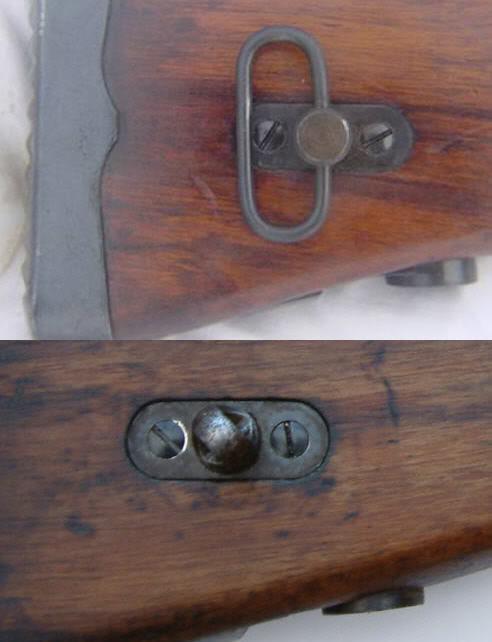

    Kevin: To answer your questions:
    My gun is marked "Zbrojovka Brno A.S." with selector markings of 30-0-1, so it's clearly not ex-Bulgarian. The sling points are a QD stud on the stock as you have pictured, the front one an integral boss midway on the piston housing portion of the receiver. The s/n is 2281, again too low for Bulgarian; only the receiver is numbered, nothing else. The bolt and gas piston/slide are both circle-HK marked, and of very fine obviously prewar machining-- in contrast to the external finish which has a very deep reblue but a "postwar Communist" indifference about the polishing under it. Unfortunately the original barrel went astray somewhere, but Britishicon-issue barrels fit and function fine.

    MGMike appologies if it appears like an interrogation
    I'm just trying to glean as much info about it for reference.As the documentation is so sparse on Czechicon Brens it is worth hovering up any details to try and make sense of it all.
    Could I be as bold to ask for some pictures of your gun (online or offline) ?
    Not sure if the South African order (that was fullfilled) for 15 ZGB33's would account for the SA mention as any design with a sliding butt group seems to be listed as Bren/ZGB33 ?
    The Irish contract I only found out about after finding some Czech made 303 30rnd magazines with FF Irish ownership markings on them.Subsequent delving suggests that they were delivered in 1937 .I think 227 were ordered but not all that number were delivered as in the Irish 1939 war stock only 82 are listed.Photographs of them show they are more like the Iraqi contract guns than model 1939/zb39 guns.
    ATB Kevin
