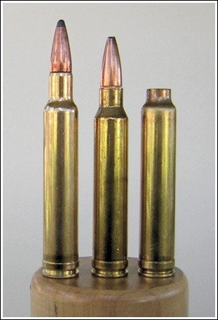

    How about this one?
    This shows a 300 Win. Mag. round fired in a 300 Weatherby rifle. Notice the unusual fired case. This could easily have been a real disaster.
    [Weatherby round on the left, the 2 on the right are both Win. Mags.]

    Yup, complete w/ longitudinal splits in the case neck. It's in my odd dead brass collection somewhere, along w/ something like a .30 Carbine round fired in something WAY too big in diameter. There was enough pressure to swell the entire case forward of the web to a surprising degree.
    The belted mag example isn't really a "bad or excess" headspace problem since technically the Win Mag did have proper headspace in the Weatherby mag chamber as it nominally headspaces on the belt. This time it's like what they did to the .303 Ross rifles in WWI- enlarged chamber.
