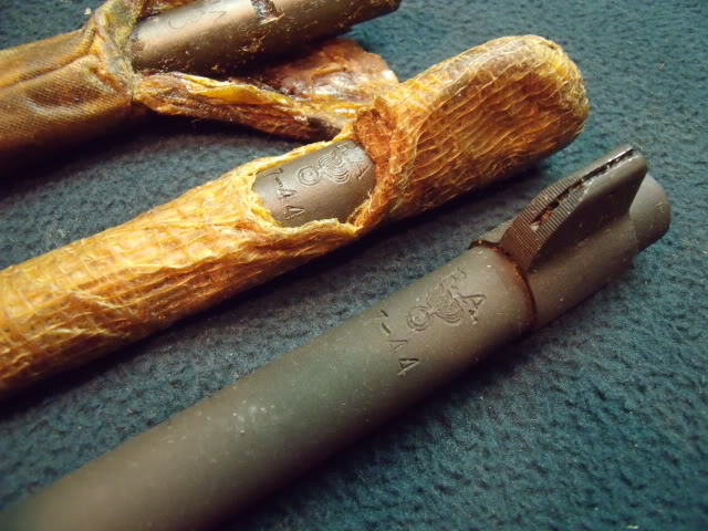

    Sarco is Sarco but I have never heard that the 2 groove 1903-A3 barrels they sell are anything but GI.
    I have one from Sarco and one I picked up at gunshow ( that may be from Sarco too for all I know)
    From gunshow in wrap on top. From Sarco not in wrap on bottom.
    The Unwrapped from Sarco is definitely not used.
    JR
  9. #28
    06-27-2025 @ 04:58 PM
    Denver Co
    62
    3,199
    chuck
    07-01-2025
    01:48 PM
    sarco buys private inventories, so, likely they assumed what they had was new, when likely it was not.. very well could have been a packed barrel from the 60,s

  10. #29
    06-28-2025 @ 05:38 PM
    2,522
    07-01-2025
    02:48 PM
    Scrapco has a big project of taking 2 groove barrels and re-cutting them into 4 groove barrels. I would avoid all of their 4 groove barrels. I always assumed the 2 groove barrels were OK. Now, I'm not so sure. I have to think someone has tinkered with that barrel. No idea who or where.
