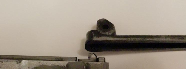

    I appologize for the nit-picky questions but you know how we are, wanting to know what every little mark means. I have one more, when I put the guts inside the reciever and assemble the gun, what is supposed to catch the protruding piece on the bolt carrier so the charging handle pulls everything back? My charging handle just slides right past without catching anything.

    I dont know if this will help but here you are. The protrusion on the bolt carrier catches on the end of the cocking handle slide. I can only guess that either the protrusion on the bolt carrier is damaged or the end of the slide is. The protrusion on the bolt carrier is part of the Piston post cotter so is a easy fix.
