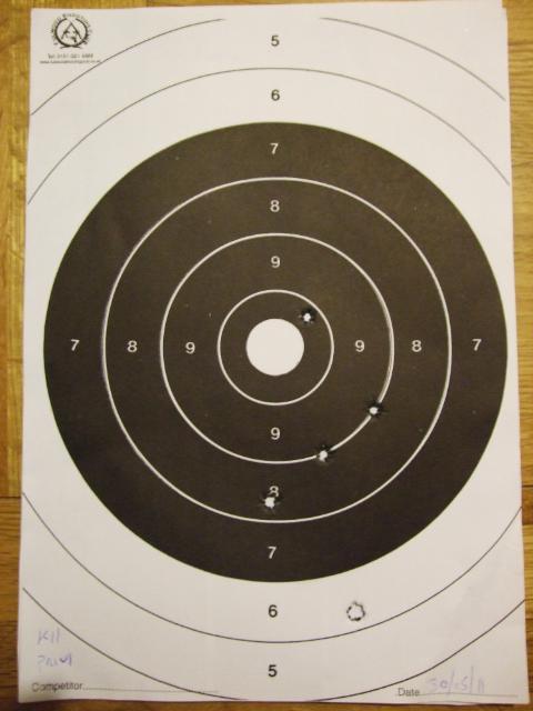

    First one for me, As Standard 7.5 x 55 Swissicon K11, (see range report) seperate point of aim used.

    Not that bad ,Geoff! See you with the "T"-challenge!

    Ulrich,
    The T wasnt preforming like it should, trigger pull not crisp enough and was short on ammo (reloads), the Swissicon K11, was ok, but where do you start with these regarding accuracy ? how much play should be in the barrel bush? etc, I forgot to mention there are some pics of the tag that is in the butplate on the Swiss forum.

    Geoff, i had a free floating bore at my rifle and you have to check the aluminium ring, there is sometimes a lot of greenish dirt in it. Clean it and check if it is really round and has no dings or so. Important is that the action is tight to the wood and i made a bedding under the chamber for that reason. Check out that the barrel is really free when it is getting hotter. In my case the forestock was touching the barrel, but only after firing 15 or 20 rounds. After that the shots where wandering to one side at the target. After clearing all of this little problems it shoots around 1"-2" with the GP11 ammo. And i purchased a higher frontblade for 24 Euros at Schwaben arms.

    Free Bush Now!
    Geoff:
    The bush at the front is nickel-silver. Which is why it goes greenish with verdigris. When I got my G96/11 it was clogged with the green gunge, so I had to clear it out. Which was awkard - as you cannot get it off the barrel, because of the front sight block! The bush should be a snug fit in the woodwork, but not touch the barrel. I suspect that your K31icon is indeed binding somewhere. binding. A properly set up K31 firing GP11 ammo should be in the class 2MOA + PWF (i.e. whatever the shooter adds in inaccuracy - the Personal Wobble Factor).
