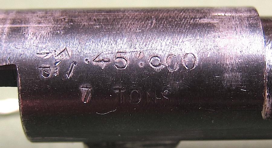

    The BNP really isn't a view mark. The view mark was applied showing the proofing was successful, as prior to 1955 there was a proof and a nitro proof mark. The BNP replaced the view mark, proof mark, and nitro proof mark on the barrel.
    The London Proof House replaced the previous three marks with a single arm holding a scimitar over NP on the barrel. On this London Proof House 1911A1 proofed barrel the NP proof is to the left of the caliber marking, and rotated 90 degrees clockwise.
