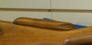

    L42a1 with birch stocks and probably birch cheekpiece:
    Another L42a1. Wood type of cheekpiece???:

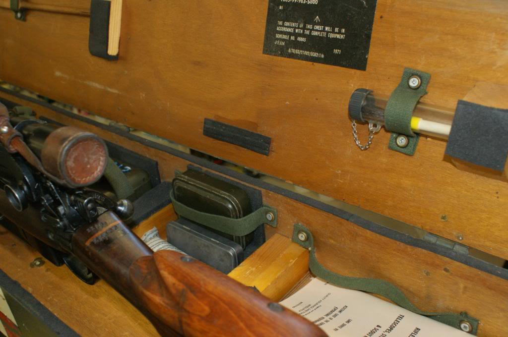

    There's a good example of a well patched cheek piece. One of the old Armourers told me that they always split at the front left side not because the wood was naturally thin there but because the underside was profiled for the No3 rifle butt. So as soon as you tweaked the front screw down, it pulled the cheek rest against the greater curvature of the No4 butt and there was a click as the bugger split!.
    There's a rare bit of kit in that chest. The 'container, pullthrough'. I suppose everyone is familiar with the why's and wherefores of this bit of kit and WO2 Steve Sxxxxxx input into this addition to the kit

    That cheekpiece on the cased rifle looks to me like one of the Colin Moon post-War replacements. Can't remember now if they were beech or birch, but of the ones I've seen all were very light in colour as supplied. The one shown has clearly been stained. The whole kit looks very nice indeed.

    Bottom picture: Is that the one you're referring to DRP? The two slip patches look typical of an old well used one to me.
