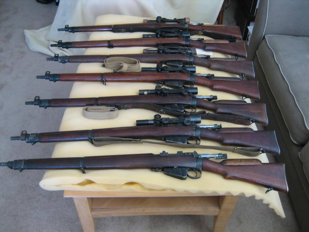

    Brian, you certainly had a very nice collection, this is an interesting topic.

    Thanks for the kind words. I still have 3 all matching rifles. Kinda wished i had kept them all but I felt I needed to focus on quality and not on quantity. I was able to use the funds from the sale of the No 4 Mk 1 T's to dive head first into the L42A1, Enforcer and L39A1 realm. That has been expensive!!

    Brian at least we know where a small percentage of No4T,s are ..... Nice collection

    Quote Originally Posted by Brian B View Post
    3rd from the bottom (And no, I have thinned down the collection considerably and only kept the all matching ones)
    https://www.milsurps.com/images/impo...IMG_1723-1.jpg
    Oh my goodness! I think I have a case of the vapors after that pic!

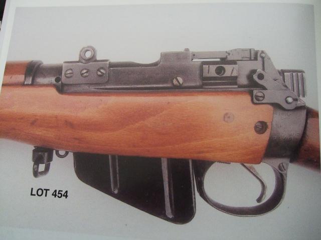

    For anyone interested the Rifle I mentioned in post #17, I found the details, the picture below is a pic of a pic form the auction catalogue , the serial number in the catalogue, was A23306, but am sure it was A2306, hard to tell in the pic. scope No 28338 (AK&S)
    (And looking at the catalogue and jogging the memory, if anyone has or thinks he has L42 (serial No 3647 and overstamped B119474) then you have the remains of a No4T but certainly not a L42.)
