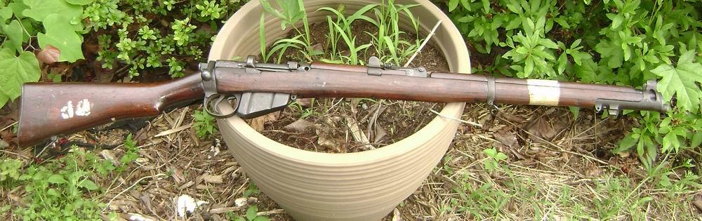

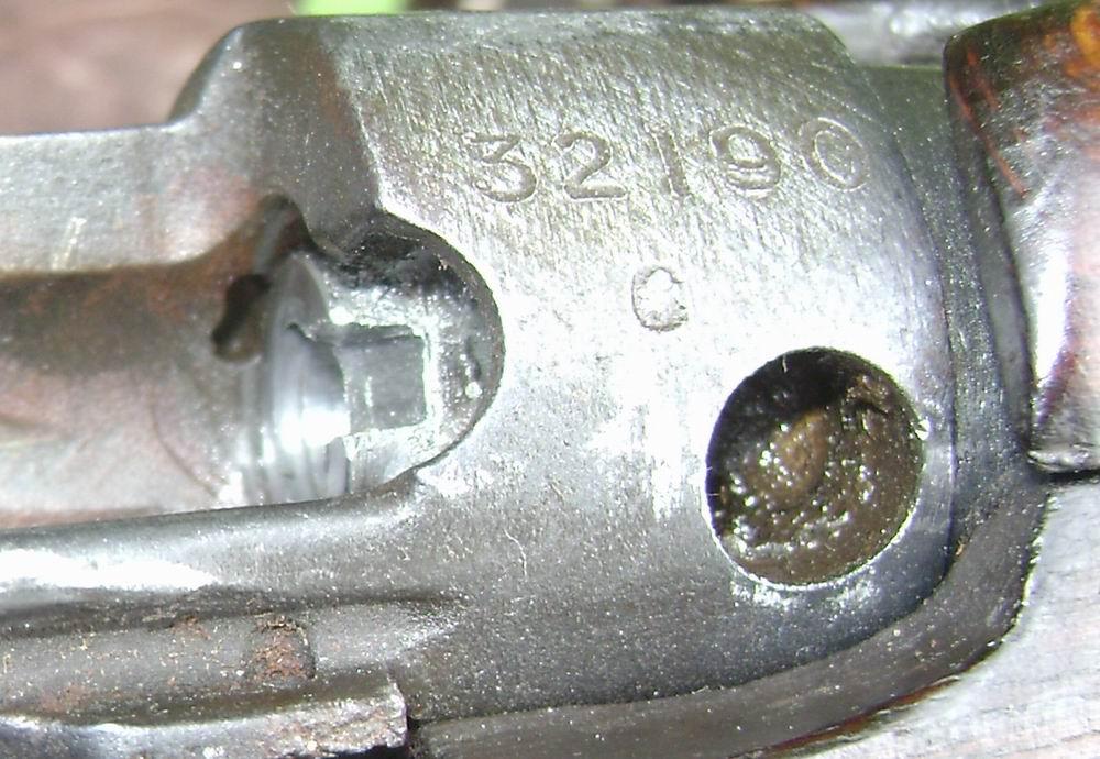

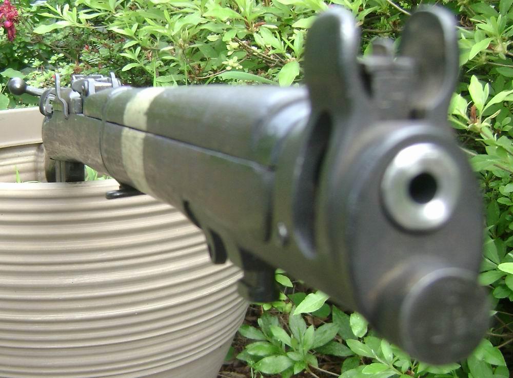

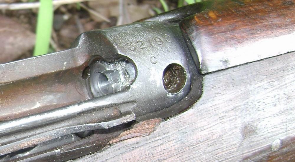

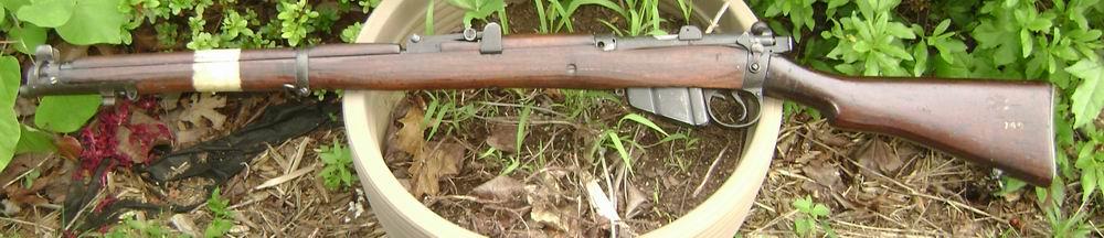

    some glamour shots

    Nice work, I really enjoy my .22 SMLE you keeping one?

    Quote Originally Posted by Roy View Post
    you keeping one?
    I intended to have all 3 but now I have one finished for me and if my boys finish 1 its theirs but if they dont finish it then its mine too.

    Outstanding work! It's great so see something which could so easily have ended up as a wall-hanger or scrapped for parts given new life as something useful for future generations to enjoy.
