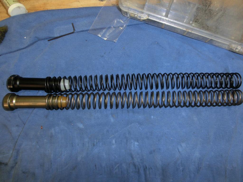

    BTW, Problem child buffer and buffer spring above and genuine Colt SP1 carbine buffer and buffer spring below.
    I don't have a scale to weigh the two buffers but what I can do is take this matching set and the BCG from the SP1 out with me the next time and give them a test go.

    Stevo, I think I will wait for the two weighted buffers to arrive and take it out again and test fire it. It acts as though the it may be right on the cusp of enough, not enough of a weighted buffer. We'll see. Thanks for the help and interest.
