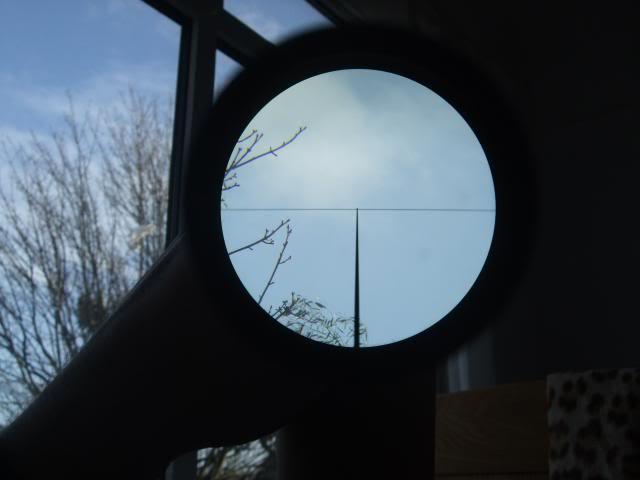

    Jovan this is a view through a L96 scope, as its not mine anymore I cant give anymore info, apart from it went to a good home and serial number was around the 1200-1400 range.

    Thats interesting chosenman, I wonder if it's the same rifle I saw, good chance it is considering the amount there are around. I don't know the origin of my scope, I have it in a bracket atop my L42

    That's the only grat I ever saw in UKicon Military service. It is a graticle as opposed to the others shown which are reticles which we weren't keen on for several reasons.
    I'm tempted to ask about the 'other' Trials unit CMan! There are only a couple of UK MIlitary and the weapons are done at the Inf TDU. I have the trials microfisches and there's no mention here.
    Just as a matter of interest, can anyone confirm whether the UK L13 A1 S&B scope grat pattern is or isn't in the S&B list of graticle pattern options. I understood that it was a one-off for our requirement. As such, and because our requirement was small, it upped the price rather heavily! It's always worth remembering too that the optical boffins at the NPL and RMCS - as was - Shrivenham trialled the scope before it was made a requirement for the rifle
