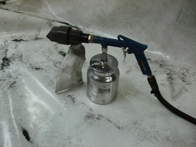

    You don't need a bead blasting cabinet, (it would help) but an easy cheap option is to get one of the spray gun types that you fill the can with the medium..... I,ve used this one in the pic and a similar one with good results. Either do it in an enclosed room or open space and use a backstop to recover some of the medium, NEVER use in the vicinity of machinery etc and use a full face mask.

    Thanks Bigduke6, I'll give that a try...

    Quote Originally Posted by bigduke6 View Post
    What does the Milsurps team of master experts recommend for medium based on experience? (I live next to a supply of fine beach sand, it's cheap, extremely abundant, environmentally safe, and easy to dispose of the aftermath, but perhaps not as good as glass beads or other types). Any recommendations on air pressure, masking off areas, etc.?

    You might find that sand a bit harsh. You can actually remove markings like that. If you use silica sand or glass beads you'll get a nicer finish. Masking is hard but we used to use masking tape and try to stay off it. I've used electric tape too. Why would you need to mask any of that off? The whole thing needs a blasting to start...I should think. Then you have a nice even finish that matches.

    Thanks for the good ideas.
    My beach sand is, fortunately, very fine.
    I was thinking of a No.4 Mk2 I have -- the receiver is very chipped but I don't want to remove the finish from the area around the electro-penciled serial numbers.
