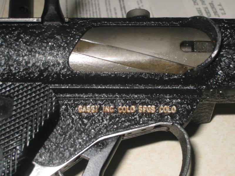

    The most durable DYI finish I have found so far is powder coat over phosphate.
    Above is wrinkle powder coat over phosphate. It’s the same stuff they use on Harley-Davidson motorcycles.
