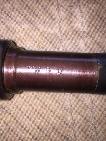

    Serial Number on the barrel is 858 and has proof markings on it.
    If you can see a serial number on the barrel it will probably be an original Germanicon barrel but if, more likely, you are unable to find a serial number on the barrel it will be a Yugoicon replacement barrel. The "thick" butt plates you mention are I think you will find are actually dished shaped and slip on over the butts giving the appearance of being thick. Personally I quite like these Yugo refurbished K98s and believe that they are massively under valued. I would not recommend trying to re-germanise the rifle by removing the Yugo markings but just enjoy it as it is. I believe that the Yugoslavs had quite a cottage industry refurbishing these rifles in the late 1940s and 1950s and some were exported minus the crest or so I was led to believe.

    68rs327, I have a similar Yugo K98icon to yours but in U.K. De-activated form. My example has a flat butt plate which is the main visual difference. Can you see any sign of "X" markings on any parts of your gun? My Yugo K98 has a feint "X" near the pistol grip which makes me suspect that Russiaicon may have supplied/sold/gifted some K98s or gun parts to Yugoslaviaicon post war. I'm not convinced that the number on the barrel is a serial number; I suspect that it could be a dated August 1958??? I have never heard of the Yugoslavs removing the serial numbers off the barrels but only off the receivers. I believe that quite a high number of barrels were replaced in the refurb programme including my example. My example has no serial number on the barrel.

    Anyone know what the number on the barrel under the wood and the arsenal marks mean?

    Picture wont load, see #21 above for photo and arsenal marks.... Also, my rifle doesn't have any X's on it anywhere..
