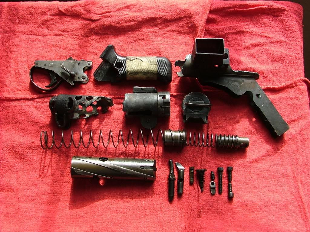

    This is about how most of them look when we get them here.
    We strip the usable parts from the torch cut body and make Mk6 copies with a new tube and semi-auto only parts. It would be almost the same amount of work to make a display. At one time display Mk4 Sterlings were selling for more than a functional Mk6 copy.

    Blimey Vincent, torch cut in three places ... or blown up! Whats the deal with the the selective fire trigger mech, are these left untouched and reusable with a semi only mod applied ?
    02-27-2020 @ 09:22 PM
    1,890
    07:39 PM
    Yes, the trigger mech gets modified. The sear is slimmed, a stainless steel pin is welded in to prevent the selector from going to automatic and section of the housing is cutaway. A steel pad is welded to body that blocks an unmodified trigger en bloc from going in.
