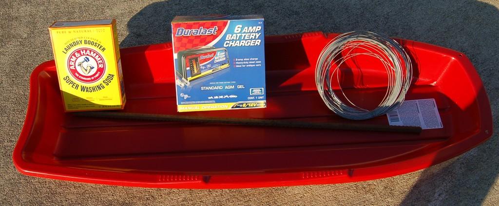

    There is a big warning on the link Hooked posted about baking them to prevent them from becoming brittle due to hydrogen infiltration. In any case, I believe I had a successful quest. Look this stuff over and let me know. Only manual charger I could locate, nearly all are automatic these days. Lowest setting is 2 amp. Is that too much? I think most guys were using 1.5 amps, not a huge difference but wanted to check. Also, is there any inherent dangers here, gasses, small children or pets being electrocuted, etc? I can return what I bought, the wire and rebar I had here at the house.
    We have guys here that have done this very thing, I'm surprised they haven't come along. I'm going to have to find the thread so you can PM some people...I think.

    Here's the thread I was looking for... https://www.milsurps.com/showthread.php?t=48590
