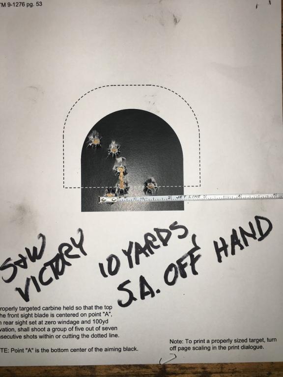

    Took it today and fired about 100 rounds. I had a ball. There was a bit more side blast from the .020" cylinder gap, but the shooters on either side didn't seem to notice, so it could not have been too bad.
    The Victory has a smooth and quick double action, even though the pull seemed about right. Very east to be "surprised" by the break.
    Single action was a joy, with the trigger probably being close to two pounds. Here's 6 shots, off hand, single action from 10 yards. 1.5" x 2". I am a lousy bullseye shooter, and this thing made me look good.
