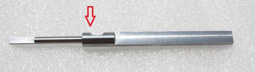

    Peter you are trying to reinvent the wheel here. This problem has popped up before in striker fired brens its the firing pin.
    If i am wrong I will buy a round of beer for everyone who has posted above here
    I know where you are coming from Peter but the semi auto bren firing pin has more in common with the SKS than it has with the original BREN. Take an SKS with an eroded firing pin tip and lengthen the slot for the retaining pin so you get FPP and you will also get pregnant primers.
    In this case the slot in the firing pin is cut too far forward allowing excessive rearward movement of the firing pin. You have 12oz of firing pin
    and striker against 2 ton of pressure on the primer cup. Pure physics at work here
    To Mr alterego can you post a picture of your bolt face with the firing pin retracted to its rear most travel. I assume you have a spring in the front of the firing pin to hold it back and by your description I also assume you are using mightylime's setup

    Quote Originally Posted by Mr E View Post
    Yes. That’s the problem.
    Maybe a picture of a semi-auto firing pin will help everyone visualize what’s happening.
    The red arrow marks the area Mr E is talking about.
    BTW. The firing pin protrusion is set by the back of the slot in the pin.
    Legacy Member tr63's Avatar
    Jan 2013
    02-05-2022 @ 08:25 AM
    maine U.S.A.
    404
    john senesy
    07-04-2025
    05:07 PM
    The firing pin shown looks like the one in my Wise-Lite rebuilt semi-auto Bren in .303 . None of the fired cases from my Bren show primer flow back . The wise-Lite firing pin is still made by a company in Boynton Beach, FL.

    Yes, it's Mighty Lime's (an individual who relishes using damned Bren guns to hurt my feelings) most excellent setup. Will try the firing pin ideas. Will attach image of same ammo shot through an FAL for a reference point...Peter I'm assuming you're more than familiar with those (as L1A1's).
    Firing pin is 0.010" below the BB face, original firing pin return spring is in place.
