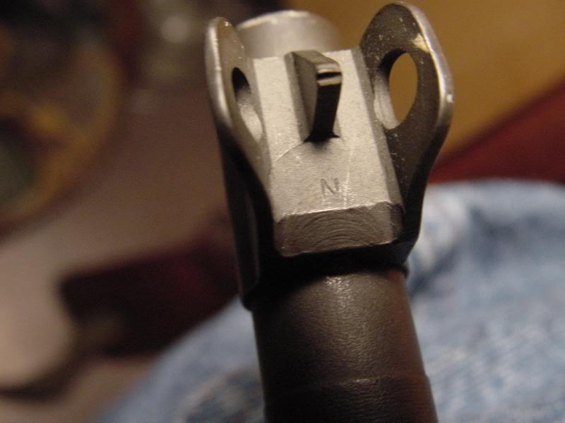

    GIUSBOB,
    Here is a NRA sale Inland 5,093,600 from Erie Army Depot 1963.
    Front sight has never been touched.
    Notice this sight was made like a A Frame?
    Having no vertical back side.
    FWIW
    Charlie-Painter777
    I know what you mean by "never been touched," but it'd be hard to explain that gouge at the top of the blade to a layman. Now I'll have to go see if I can take a picture of a sight at that angle, and make it look like an A Frame! I've seen other "N" sights machined similar to this one, without the appearance of the blade as sitting on top of a narrow rib. This one is way different than any I've ever owned. - Bob

    There might have been more, but I just saw (2) carbines on display at the OAC show Sunday morning. Both were Inlands with upgrades and a few mixed parts. One was on a vendor's table and priced at $1275. The other was carried in by a guy (wife was with him) and was asking about the value. It was his first carbine and purchased recently at his LGS. The only thing he had done so far was carefully clean and re-oil the stock. It was an IO Type 3 with a faint rack number on the grip - stock looked nice. A "carbine buddy" of mine disassembled it for him and we both told him the markings we saw on the various parts. We gave him an estimate of the value being at least $750-$800. He and the wife both looked pleased to hear that. He hasn't fired it yet and wants to keep it. Said he paid $240 for it, because "that was the price the gun store had on it." So, the moral of the story is, there are still deals on carbines if you look in the right places! Charlie, here's my best tries at making my Inland front sight look like the "A-Frame" you pictured above. Over on the CC Forum, Dan and others have a thread on Niedner sight markings - explaining that the rib behind the blade was sometimes machined off to change (or repair) a previous stamp job. Sounds good to me.
