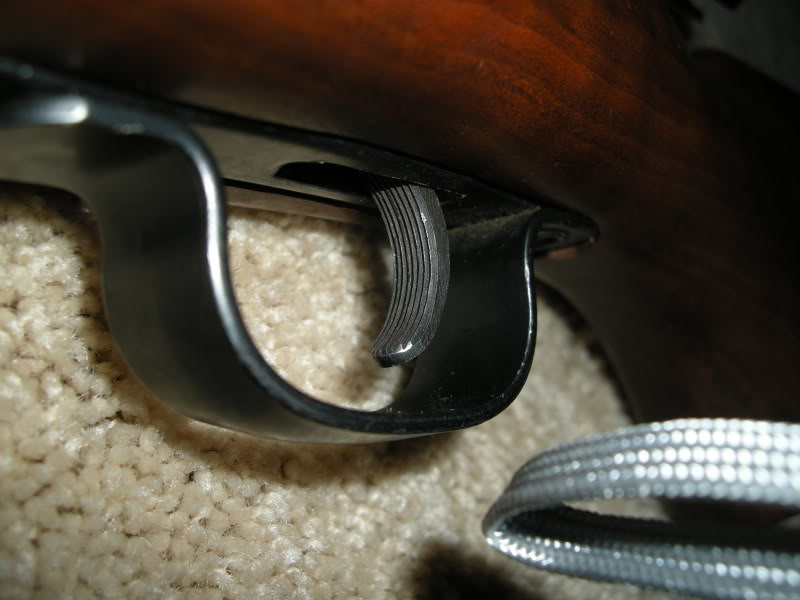

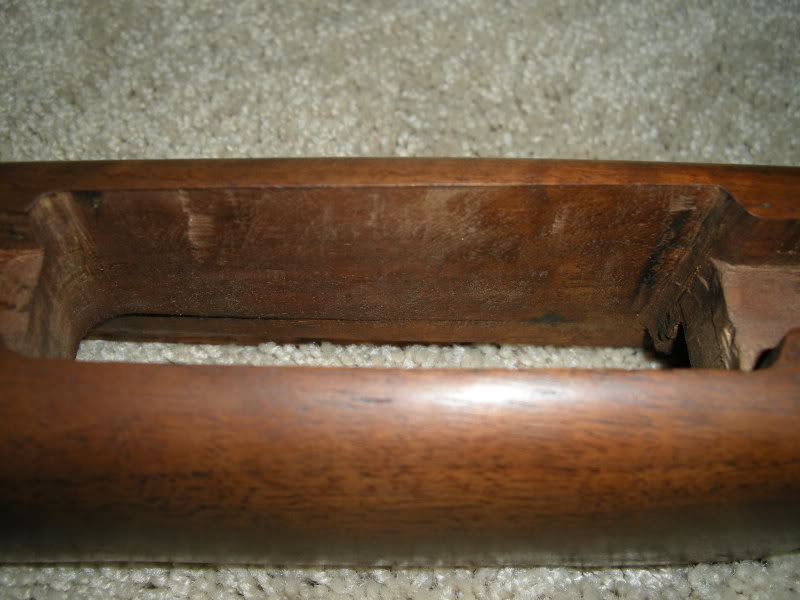

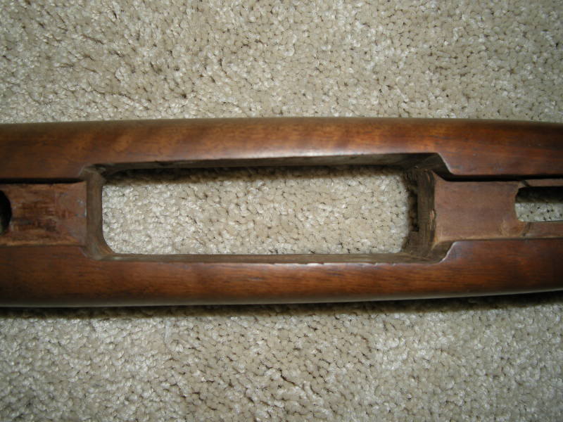

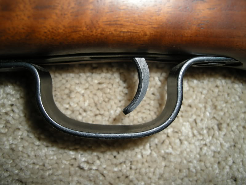

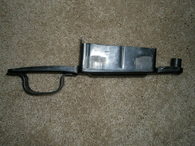

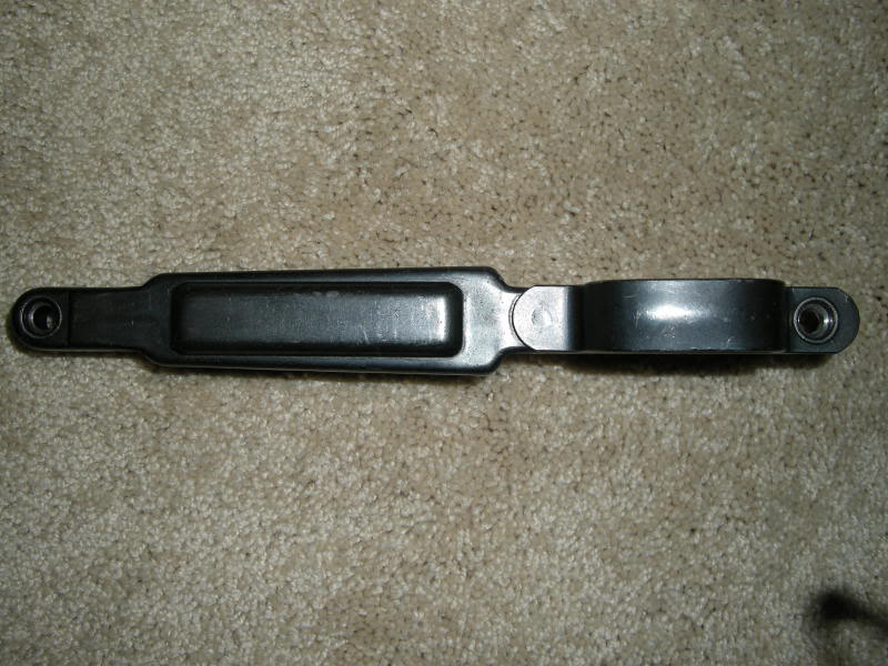

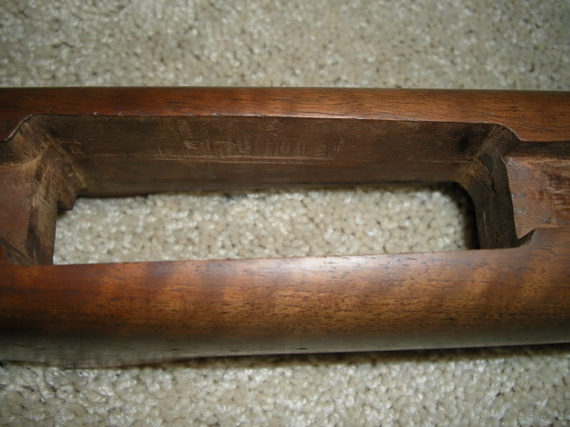

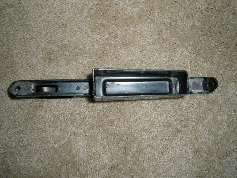

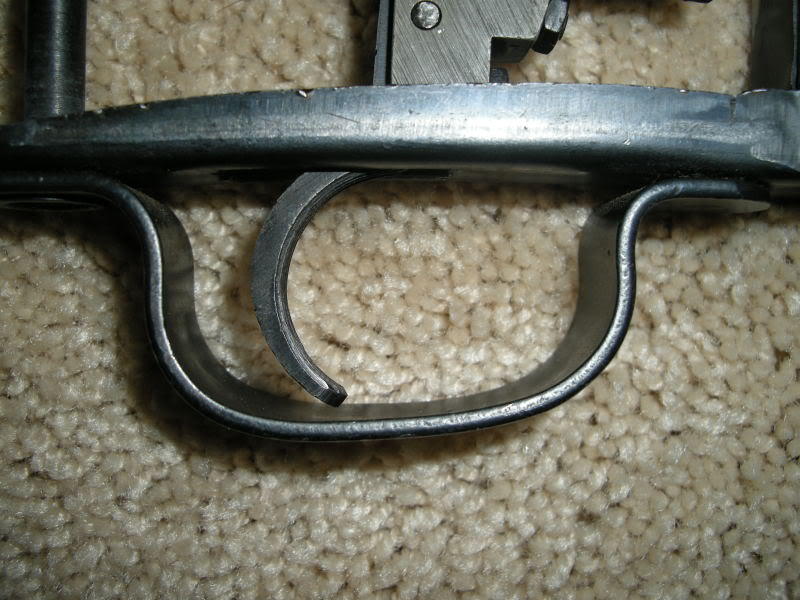

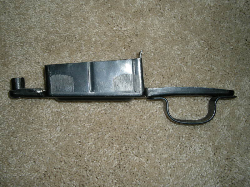

    OK, I took a ton of pictures of the stock, trigger guard, trigger, grigger guard bolted to the reciever with and with out the stock. I also ran the live ammo through the rifle (no firing pin) without out the stock, and 5 rounds fed and ejected perfectly. I do however have a new theory which I'll explain in a minute. First here are the pictures of the stock where the mag fits from the under side and of the trigger guard, which is a stamped peice.

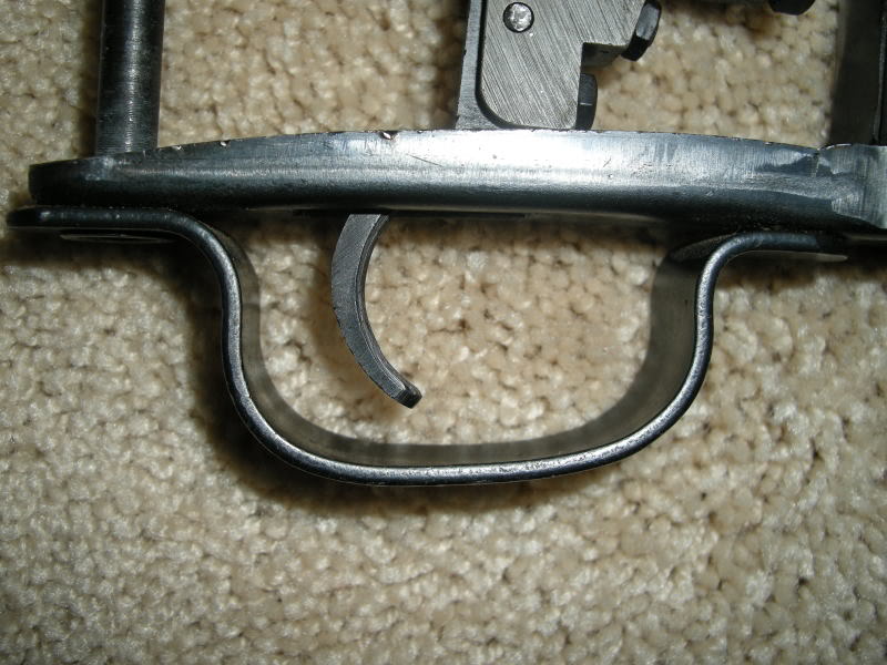

    Trigger guard. Notice in the second picture, the weld or solder by the bolt holes.
    Trigger. I don't think this is an orgional trigger:
    Here is the rifle back in the stock. Notice the gap between the the bottom of the trigger and the trigger guard:

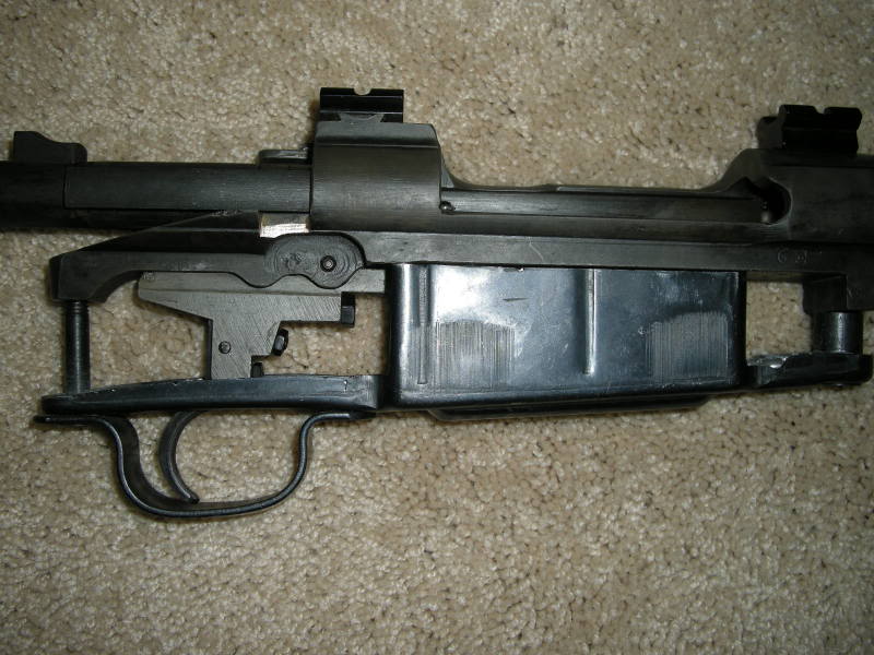

    Now, here is the rifle bolted together with out the stock. In the second picture, note how the mag comes incontact with the reciever.

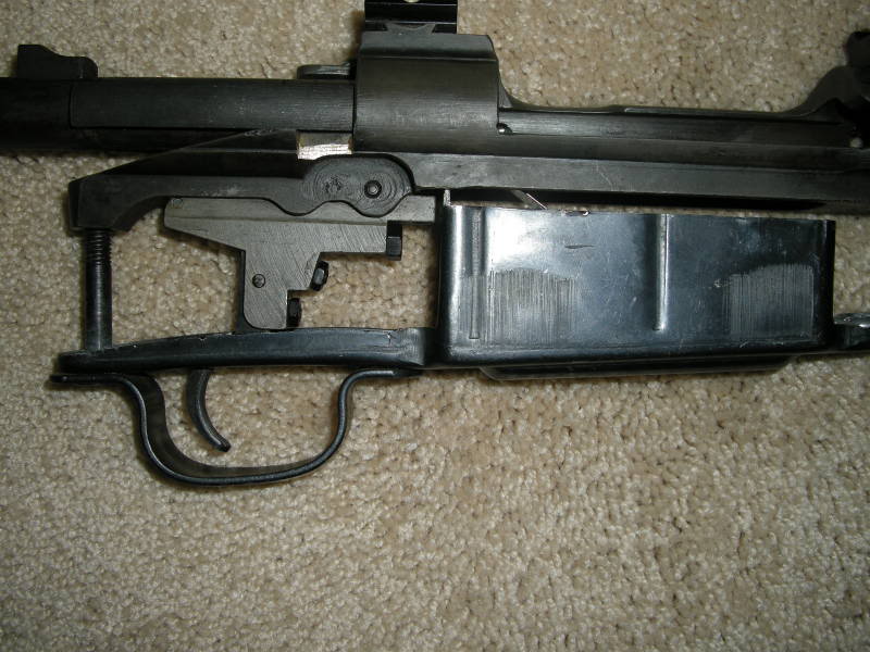

    Here is the rifle, with no stock, where I have unscrewed the screws so that the gap between the bottom of the trigger and the guard is about the same as when the rilfe is together with the stock. Look at the gap that is between the mag and the reciever. I ran rounds through the rifle like this, and, like when the stock is on, the final round ejects with the second to last round. So I think that the issue is that the mag and the reciever are not mating up at all, causing the follower to stick and the last round to pop out.
    Thoughts?

    well, i see a few issues. fisrt is the after market trigger, it can give you fits, and im suprised it works with the stiker assembly without fitting, and is the reason your safety doesnt work,
    second, the trigger guard looks like its been modified at the top, id find another.
    third, the stock needs to be fitted alot better, the trigger guard doesnt seat into the reciever well enough, that in itself is your issue with it popping out.
    i would say the stock need to be fitted by a gunsmith that knows how to fit a rifle.
