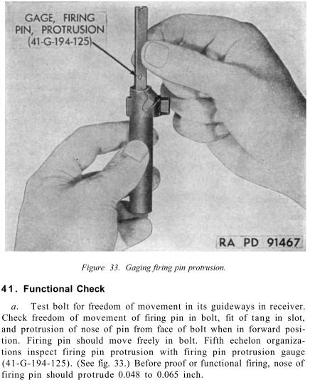

    Quick update. I spoke too soon. That carbine failed to fire the same ammo - once during a CMPicon Garandicon match. Short version is that both 'duds' fired fine in my SG.
    Changed bolts and firing pins but measuring the protrusion (as pictured in the 1947 tech manual) suggested that alone wasn't going to answer.
    Installed a new hammer spring and took it to the range last week. Fired 65 rounds of the same ammo as before without a hiccup.
