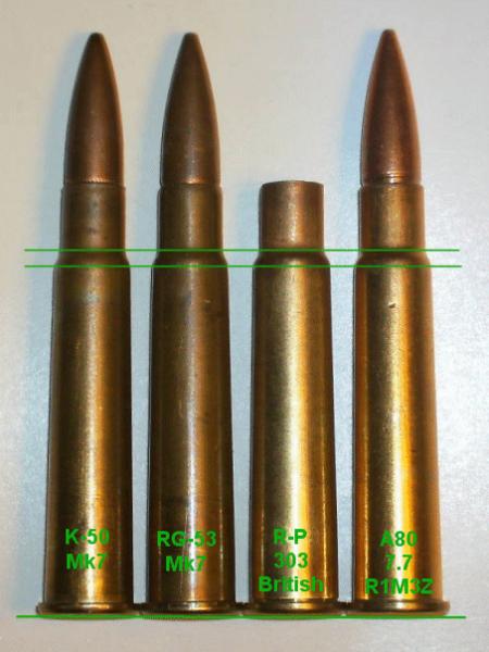

    Seems to me there's no significant difference in the shoulder location of unfired .303 cases or loaded ammo in my little stash - regardless of national origin
    Anyway, it hardly makes much difference since the chambers are designed with plenty of clearance at the shoulder, and the intent is for the cartridge to stop on the rim long before the shoulder touches (mud, not reloading, being the original plan).
    Near as I can figure, the purpose of the shoulder in the Wilson gauge is to alert the user when the head-shoulder dimension is too long - which would leave the cartridge base protruding above the back end of the gauge. That could be a useful bit of information to help reject cases that need some F.L. sizing to fit in a (mythical?) "standard" chamber.
    Mr. Horton is confused about my case stretching tests. The one I reloaded "19 times without any case stretching." didn't involve any spacers (neoprene, nylon, or otherwise). It was an R-P commercial case from which I removed the rim to demonstrate that the skinny .303 shoulder was entirely adequate for rimless-style headspace control in a neck-size-only operation. As can be seen in the image below, there ain't no place to put a spacer on this one!
