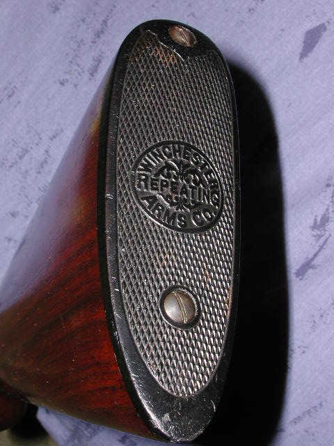

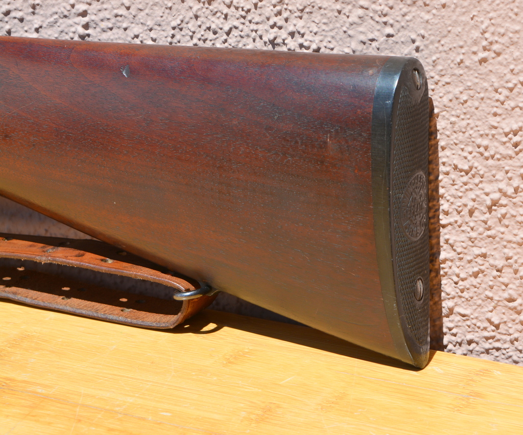

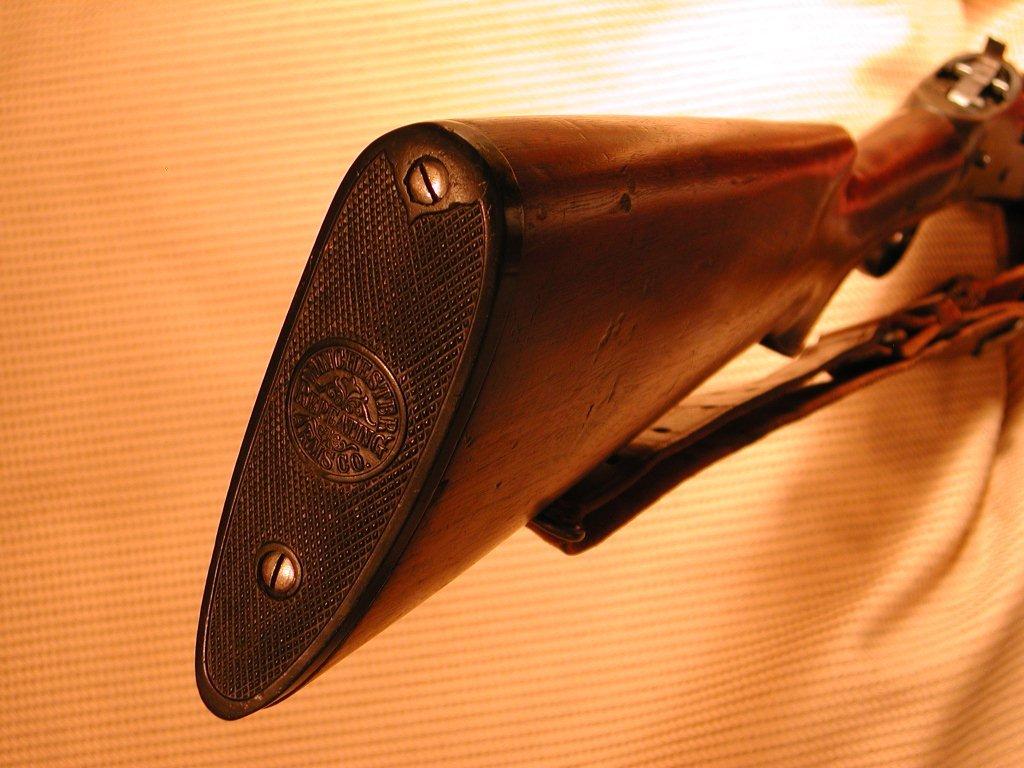

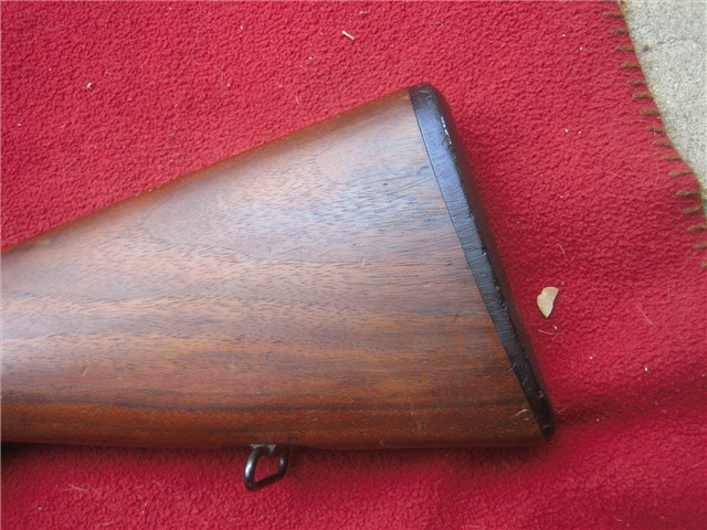

    Here's some photos of Model 1897 butt plates. They were hand fitted to the stock. So, the chances of finding a loose one that will fit perfectly are not very high.

    Thanks Tom! The repro one I have fits...a tad oversize in a couple spots which gives me something to work with. The bottom of it is flat, and uniform thickness top to bottom. My stock has a slight curve from top to toe, just like your's shows in the 4th picture. So my question was should I heat and bend the buttplate to fit the curve, or file off the curve of the stock flat. Your pic answers the question - neither! The thickness of the buttplate needs to taper towards the toe. I think my repro with some tender love grinding the right profile on it's underside will work just fine and look great in the end.
    Thanks again!
