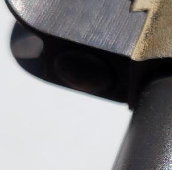

    Does it still have the sight seal. The picture is dark in that area, unless I’m missing something. Regards
  7. #25
    Today @ 10:20 AM
    31,013
    05-03-2025
    03:49 PM
    Quote Originally Posted by cpc View Post
    Looks like it...

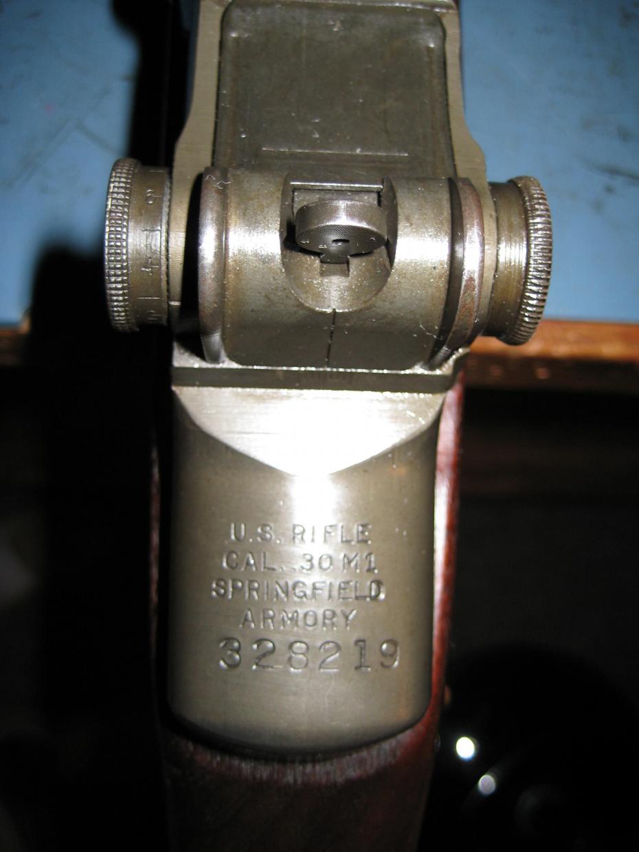

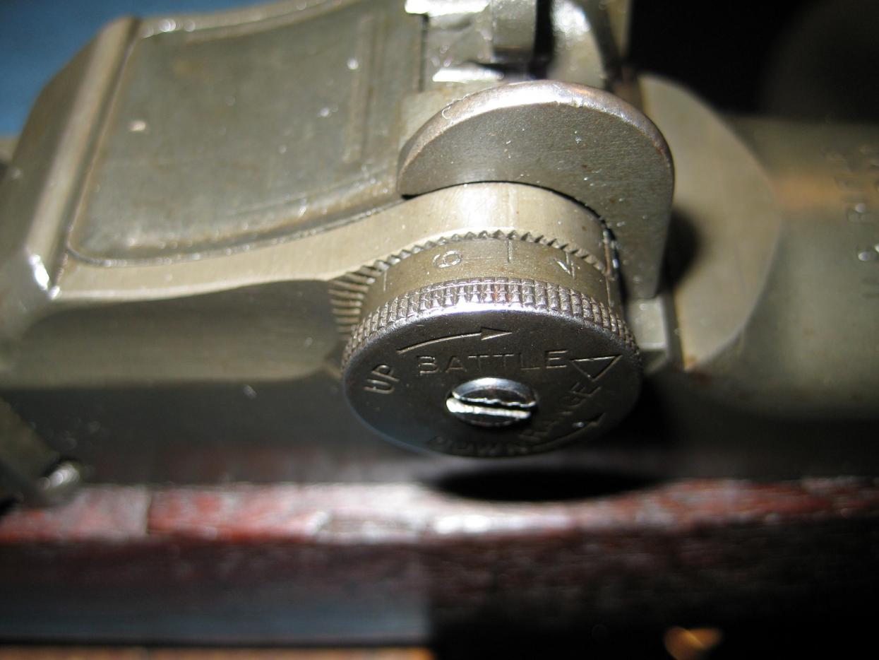

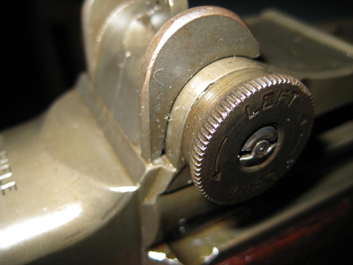

    Mine was 328219 SA and a checkered cap.
