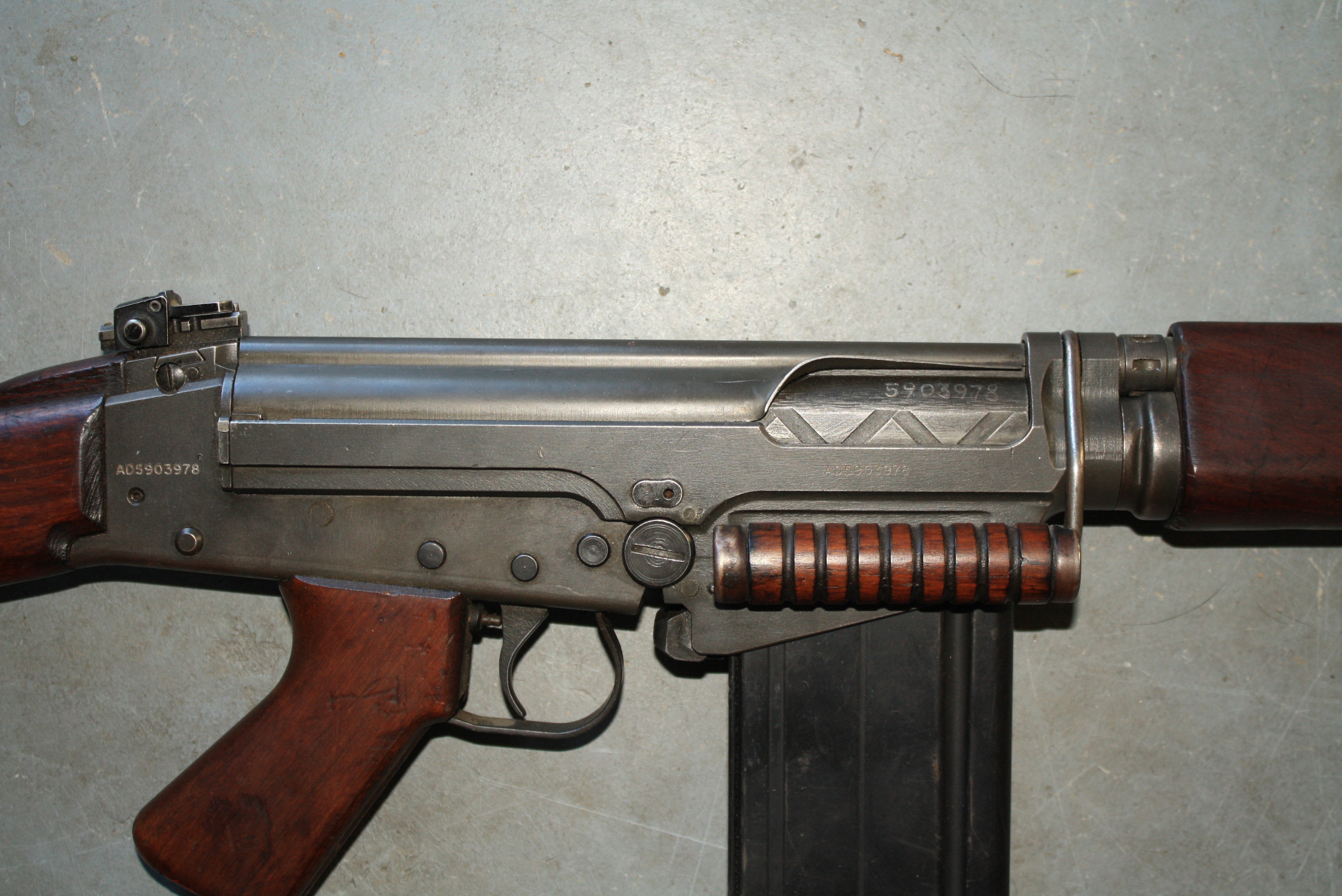

    When Lithgowicon began L1A1 production in 1959, the carry handle was non-rotating wooden (the end of the handle engaged the wire by half the wire diameter). These soon changed to the rotating wood then in the '60's to the green finger-moulded plastic. NZ removed all the carry handles during the mid '60's so the rifles would always be carried in a semi-ready position. The attached photo shows my 1959 NZ first issue SLR with the non-rotating handle.
