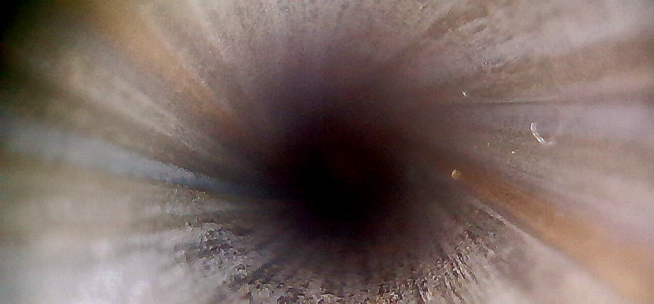

    I tried to photograph 2 of my barrels, my Garandicon while dirty is pristine and a perfect example of 4 groove Springfield rifling. The 5th line is just copper from firing. I really need to get to cleaning these rifles after the holidays.

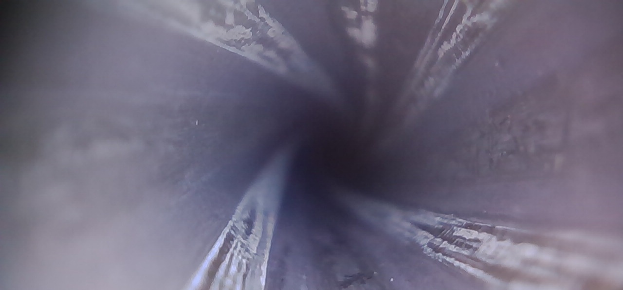

    Second is the only 2 groove I own a Maltby Enfield No4 MKI. It is also dirty and kind of hard to see but it is exactly as described. 2 large flats and 2 grooves, in this case the 2 copper color lines to the left and right.
    The 2 groove was adopted by the allies as a wartime expedient faster and easier method of producing barrels. They provided acceptable accuracy and were indeed faster to make early on. Eventually it was found that production had met the pace of necessity and Enfield and Springfield both returned to conventional rifiling.
