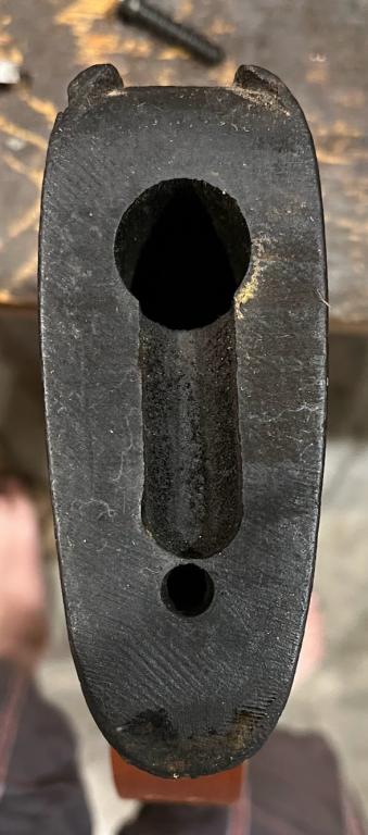

    here's a photo with the buttplate removed.
    Looks near identical to your stock though I don’t have those star stamps.

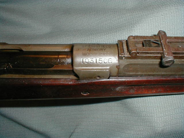

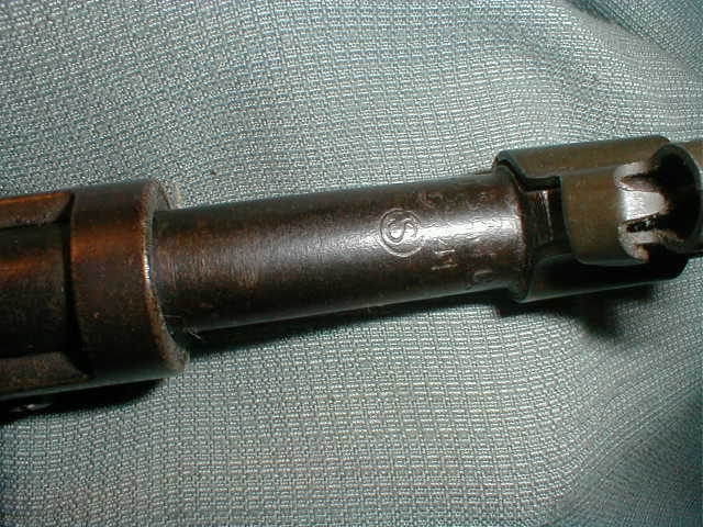

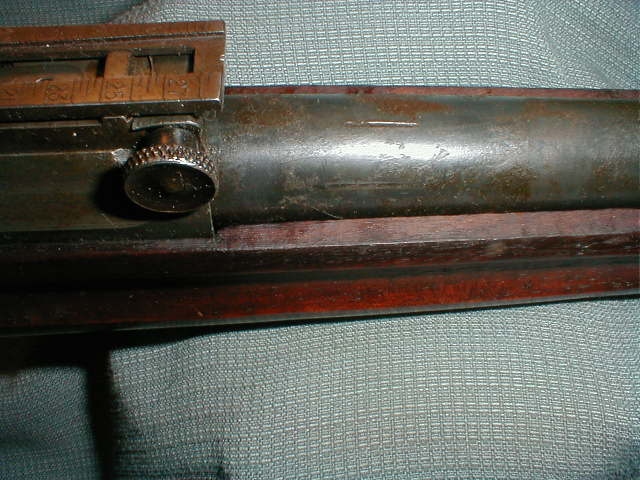

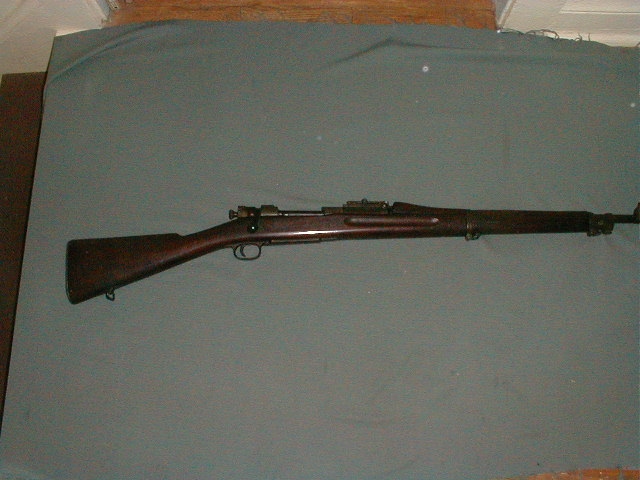

    Another USMC rebuild
    This rifle was purchased in 1962 at Kleins in Chicago by an employee working part time. later he sold it to me, never fired this rifle. Barrel is also 9-41 plus all the other (I think) features related to USMC rebuilds. The late Frank Mallory of SRS told me he was certain it is a USMC rebuild as ther serial number is among other USMC rebuilds.
    Stock is from WW1 but without cartouche but has small eagle stamp - stock was not a rebuild.

    I've never seen a 1903 stock where the lower band spring's pin was visible, nor where the inletting showed the rear cross bolt. Then again I admit I haven't handled enough to know for certain whether they ever came that way or not. Now I'm curious.

    Me too. This was clearly made a long time ago on machinery, but there is a lot of hand fitting and differences to RIA, SA or RA stocks.
    It’s also black walnut, so not likely made outside North America.
    Some people seem to postulate Sedgley may have produced a run of these J stocks in 41 or 42, but as mentioned above, there are records discussing a negotiation to buy S stocks from Sedgley but anything that might prove an actual purchase definitively took place was destroyed and is no longer archived?
    In any event, I plan to keep this rifle the way it is, shoot it and enjoy it. Who knows, maybe one day there will be more info about these that turns up. I’m happy with it as a representative M1903 in my collection, maybe some day I’ll add other examples if I come across them. Any 1903 is uncommon in Canadaicon.
