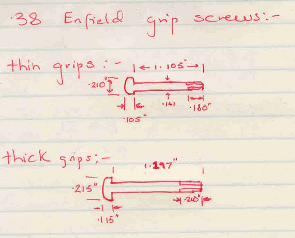

    Since the problem has been solved, it isn't really needed anymore but here is a sketch I made from measuring two grip screws for the thin and slab-sided grips, in case anyone else needs the solution.
    The thread is 4BA, of course, and it's easy to make the nut/escutcheon on the lathe, though it's best to have the grips present to fit it properly.

    Many thanks Jim. Has been added to my "stash of info". I note the "past tense" referring to the 1939 model. If you ever make it across the herring pond, let me know and you can "exercize (exorcize?)" some elderly Webleys and Enfields to the limit of my ammo (and I reload for 38/200 and 0.455). dave_n
