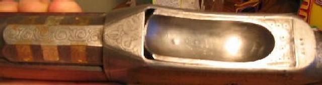

    If I had the money the metallurgy any of the rifles could checked.
    I did an acid etch trying see if I could raise the markings with out much luck. There were shadows and the impression I got was the shape and location of the marking of the the Kabul Arsenal marking. But that is purely speculative on my part, it could be something else altogether.
    Undercut.
    Here is bearhunters rifle.
    Here is the same area on the number 2 rifle.
    Notice how much of the rounded knuckle of the back of the breech block is exposed in Bear hunters rifle vs rifle #2. The back of the action
    I went through all my martini pictures, and every martini I have here-22, and none of them expose the knuckle like bearhunters.
    MHCC
    Bonehill converted MH
    Westley Richard Commercial action
    Arab made Martini
    A MH MKVI and a ME
    MH
    Turkishicon Peabody Martini with damage seat.
    Well you get the idea

    John that's the problem.
    We know that the metal of the Martini is a specific formulation of a mild steel.
    We don't know what the metallurgy of the rail road iron or whatever steels that may have been used with it to make the KP rifle-that is the concern.
    Rail road steel is hard, MH steel is not.
