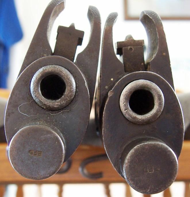

    I'm not very up on early SMLE's; is that the correct foresight blade?
    Correct blade, here is a photo of my two 1904 Mk1 SMLEs
