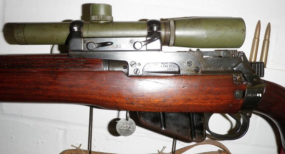

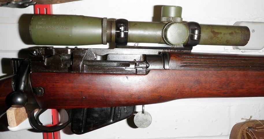

    Anyway, I see the C67 rifle at the S.I.M. has the front ring cap on backwards.
    https://www.milsurps.com/images/impo.../12/ybjd-1.jpg
    https://www.milsurps.com/images/impo.../12/394y-1.jpg
    Any chance you can show some pictures of the stock and the Forend of the rifle.

    Here you go then.
    [Oh, sorry, uploader failed again]
    One other photo of the scope markings and does the scope match the rifle, thank you.
