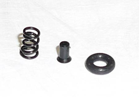

    Extractor upgrade kit with five coil spring, rubber plunger and an "O" ring.

    Might do the job. Though it seems like it should be more likely to be the ejector.

    Bill, with the case not leaving the bolt face, it may be the ejector spring. I had one that snaped, then spiraled down within itself. Needed a dental pick to get it out.

    I agree it has to be the ejector, you say you changed that though? The spring that is...the ejector it's self usually doesn't fail. When they're working, you can't get a case to stay put on the bolt face.

    While you have the ejector out and if you find nothing obviously wrong like broken parts check closely for burs on the bolt face around the ejector port opening or on the ejector itself. Also run a pipe cleaner or brush down in the port to remove any contaminate build up and brass shavings that may be hiding there.
    All AR ejectors I've seen have flat faces with sharp edges and possibly even tool marks that can and often do shave slivers off the case head when the bolt cams to lock up. These slivers sometimes work their way down in between the ejector and bolt body and can cause intermittent sticking and FTE's like you are experiencing. I had this happen a time or two with my 6.8 AR until I stoned the ejector face to remove the tool marks put a slight bevel around it similar to the M1icon carbine ejector. Had no FTE's since.

    Well today we went out shooting and I took the BCG from my Colt SP1 and ran it in the shorty and it worked flawlessly! Then I swapped the bolt carrier back to the original shorty using just the Colt bolt and it ran perfect. There is something wrong with the bolt. I put new rings, extractor and checked and rechecked the ejector and ejector spring and they look perfect but obviously something is wrong there. New bolt time!
