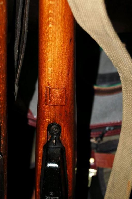

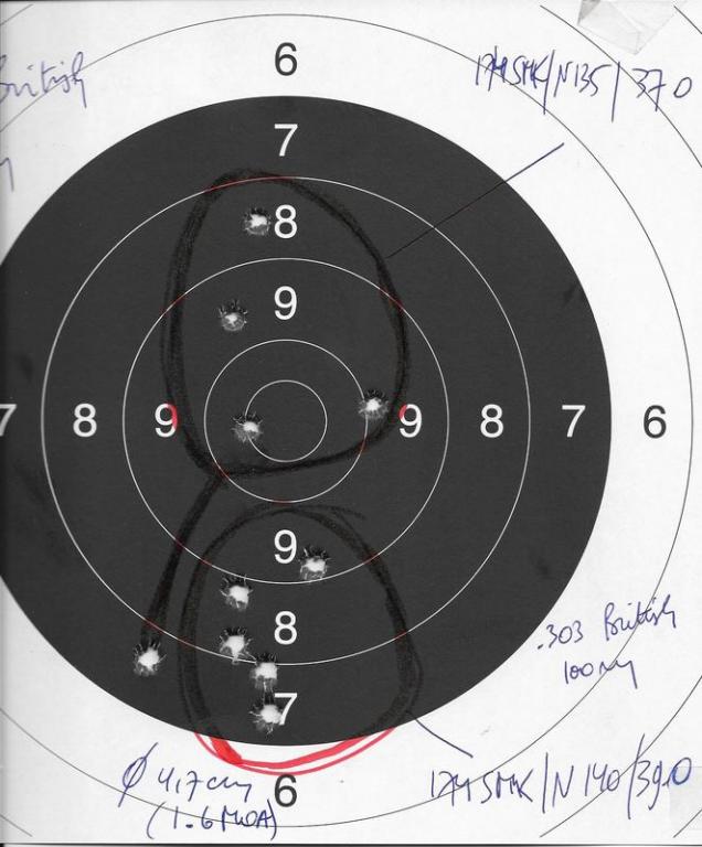

    This ancient post raised my interest as I recently acquired a N°4 MkI* made by Stevens-Savage, anno 1943. The rifle is stamped FTR and has a new stock and barrel. The latter is free floated at the fore end but has an insert (pressure point) about under the junction of receiver/barrel. With 174 SMK it shoots 1.6 MOA at 100 meters.

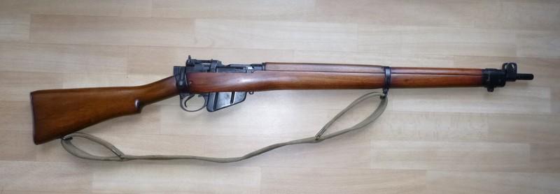

    I own a No4Mk1/2 that was regulated by Fultons at some time, it shot well from the first time I tried it and after trying varying reloads I have found a good set up.It will shoot close to 1MOA in the right hands (not mine).
    It should be remembered that the No4 rifle came out at the start of WWII and probably did not get seriously looked at as a target rifle until after that conflict; which would explain why the "target" crowd continued with the No1 rifle for a while. The military probably did not look at further enhancement after the war because when set up properly, it did what it was supposed to with good accuracy for a service rifle.
    I have recently set up a No1MkIII* for service rifle competitions, and I stayed with the original type set up. I wanted to see how good I could get it before deciding whether to go the "bedding" route. To be honest, it's shooting very well in standard form; not far off the No4 in my hands.
    Attachment 76301Attachment 76303
    The two 10m targets are the No1MkIII* testing SMK and SB bullets.
    The single target is the No4 rifle shot by my friend Charlie, first time he'd tried this rifle (and he's left handed) Both are at 50 metres.
    When I shoot them, there's really not much in it!
