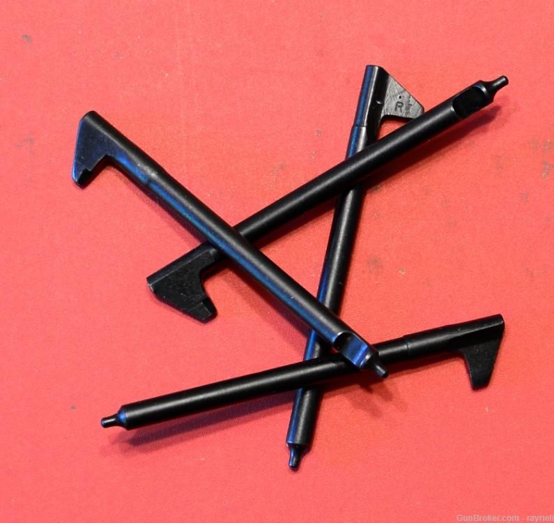

    In this picture below, the rounded tip of the firing pin looks broken off. Like Floyd pointed out it looks like a Flat nose. I wouldn't be surprised to see the slotted area of the Firing pin is wobbled out where it intersects with the stem of the Extractor... Allowing the Firing pin longer travel. Have seen this before.
    If you enlarge the OP's last picture of the bolt face... You can also see under the Plunger cone that the extra webbing (below the left side of the Extractor) has a rough/burred area. To me the Primers have a larger diameter impact area, not like a U imprint the spent casings in my hand look like. Maybe this 'Blunt Impact' is in part the reason the Primers are backed out?
    If mine, I would swap out the Firing Pin, File away the rough edge on the bolt Web, install a new Extractor, Plunger Spring assembly, and install a new Ejector spring. If the Ejector tip is in good shape and working properly it could stay. But for a few $$ more you could have a rebuilt bolt and change the Ejector tip/spring assembly. Anything still in serviceable condition become extra parts.
    I'd be interested in seeing a Macro pic of the current Firing Pin tip.
    Pic from a Auction showing Firing Pin Tips:
    Charlie-Painter777
    https://www.milsurps.com/attachment....7&d=1624522462
    https://www.milsurps.com/images/impo...55939672-1.jpg
    To me, it almost looked like pictures of two bolts. A couple shows a possible flat tip, but one for sure looked normal to me. The strikes on the cases OP posted looked just fine to me (the strikes I mean), but as already mentioned, they are the ones that fired.
    Charlie, click on those in post #23. They go so "macro" you might have trouble finding the firing pin. - Bob
    Attachment 118225

    Hi GIBob,
    I used his last bolt picture from reply #23. To me the Tip looks Flat, not having the rounded point we'd expect. And the Primers look Punched instead of Poked.
    Could just be me, but I believe the Firing Pin is the problem or part of it.
    I'd rebuild the bolt and file that Webbed edge smooth.
    Floyd and Double HH are good at finding the Squeaky Wheel and fixing it. Can't get our hands on all of them. Guess we just wait and see what the OP can figure out.

    I think we need to revisit this test. In think we still need to ascertain the actual head space. Maybe firing by lengthening the case with these stickers caused it to fire, but unless the primer has been moved closer to the bolt face, I can’t see how this helped. Like already mentioned, firing empty primed cases will usually result in backed-out primers. Long head space can also result in backed-out primers. I don’t think we really know at this point if OP has shown us fired primed empty cases or live rounds.
    I just think an accurate head space measurement is in order and the bolt has to be striped for that. Everything else on/in the bolt can be examined as well.

    I had a few firing pins in the bin and picked up a bolt just to measure protrusion variations in a particular bolt. I took an I-I, RI and an RI c and measured protrusion of each. It ranged from .055 to .065 among these three pins. .010 can make a huge difference in whether a carbine will fire or not, especially if it is a little long on head space, or the brass is on the short end of spec. All firing pins are not created equal.
