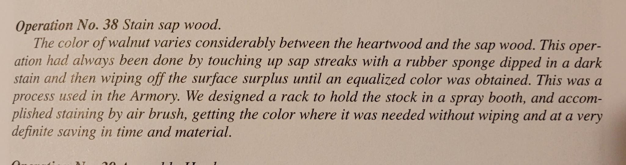

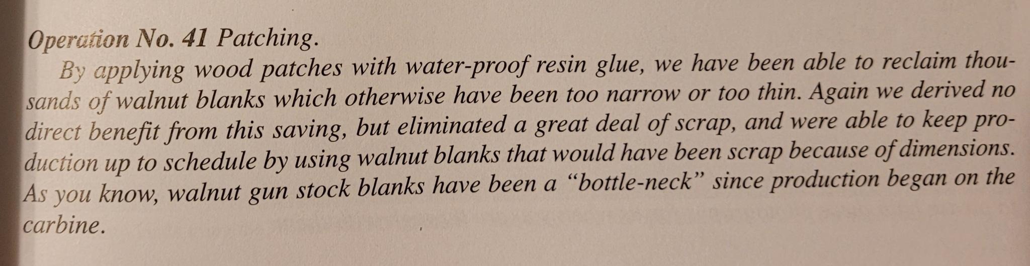

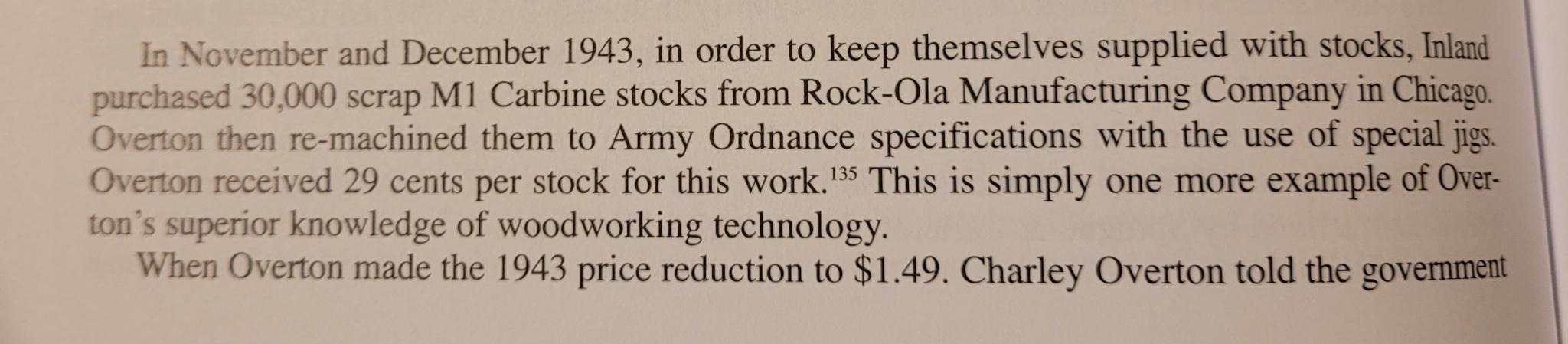

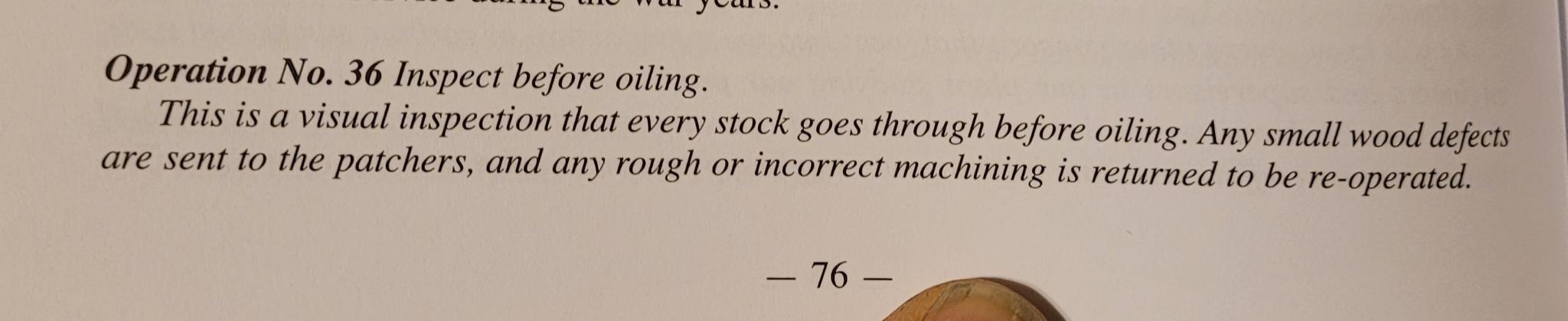

    Repair of "Scrapped stocks" as well as additional reworking of stocks and blanks
    To meet final quotas or fill the final order they requested they be allowed to complete? If the gov wanted to stop procurement could a manufacturer be reasonably assured that that component wouldn't go into service for use for a long time if ever? Its only supposition unless I can find something written.
    Also, we have record of 30,000 scrap Rock-Ola M1icon Carbine stocks being reworked by Overton.
    Wish there was a way to get some additional insight into this. When a stock was truly condemned how would they have been dispositioned?
    Also some additional comments from the book about Overtons heavy patching, light patching, as well as equalizing color by hand with stain.
    I'm not making any claims that this was done with the Garand or M1903A3, but its interesting that it was done.
    The person who wrote the book was so keenly interested in the Overton saga that he even has write-ups on many of the employees during the war years.
    Is there a book that delves into the history of the Springfield Armory like that? Where more information might be gleaned?

    told the government what? (second pic). We must know how it all ended!

    Springfield absolutely stained stocks. I get so tired of people saying they never stained. I have handled 10's of thousands of stocks and can tell you they stained them. Also all the Barn wood stocks I have straight out of WWII are stained and oiled. Rick Bicon

    Yes, I once had a picture of the sample stock color used at IHC. If it was lighter than the sample, they stained it.
    Now this makes perfect sense. I never believed staining was abandoned altogether. Why then would so many contractor-made USGI field replacements have been stained? I've seen many of those.
    I read in one of my references staining was standard practice during trapdoor production and prior. I can't recall whether the book stated it was Kragicon or later when when the practice was eased (e.g. not necessarily staining EVERY stock, or only staining very few, etc.). Rick/Bob, your point connects the dots on this. Would love to see the picture. I'd love to find that picture of the Springfield dunk-tank too. I remember the tank was level with the floor, and guys were lowering a jig from above that had many stocks on it down into the vat.
