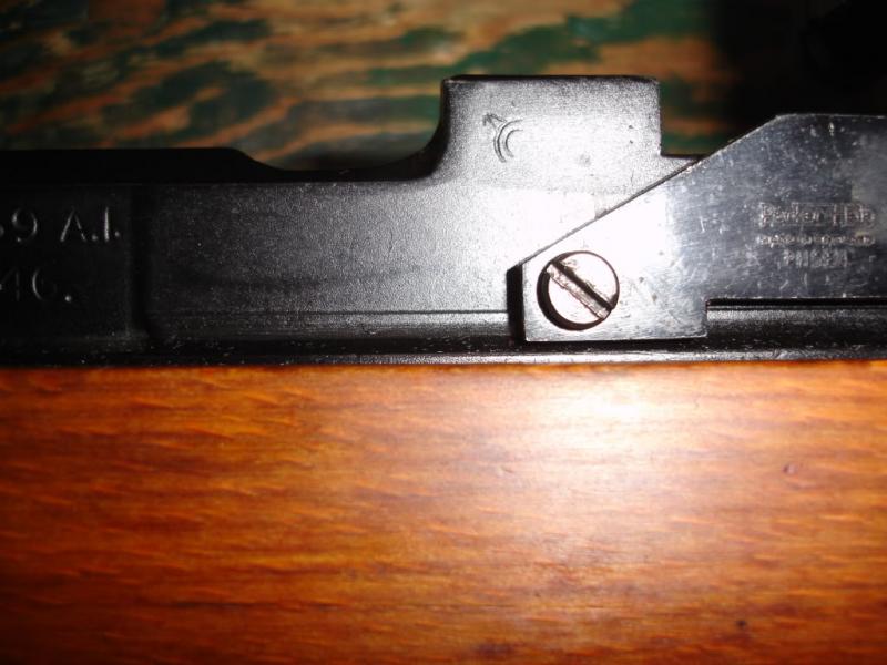

    Quote Originally Posted by Strangely Brown View Post
    These are some images of one of my L39's; can anybody identify what the previous circle mark might be on the reciever, also there appears to be what's left of a Fazackerley "electric pencil" broad arrow near the serial number, which incidently is A1025, quite late in L39A1 terms.
    Hiya Mick. Mine carries one of those half arsed circle stamps as well, but it's further forward on the receiver.
    Last edited by harry mac; 02-25-2010 at 11:01 PM. Reason: Error in original message.
  7. #45
    Legacy Member harry mac's Avatar
    05-16-2024 @ 06:10 PM
    Norfolk, UK
    470
    06-07-2024
    04:44 PM
    Seeing as that's 3 of us that have the circle mark stamped on our previously used L39 bodies. Could it be an inspection mark indicating it as being in suitably good nick to be utilised in the L39 program?
  8. Thank You to harry mac For This Useful Post:
  9. #46
    Legacy Member PrinzEugen's Avatar
    Mar 2008
    09-08-2023 @ 06:42 AM
    Staffordshire
    580
    06-07-2024
    04:44 PM
    I could be wrong but I think mine's (with half a circle stamp) a previously unused mk2 body guys.
  10. #47
    jmoore's Avatar
    06-09-2023 @ 04:20 AM
    US of A
    7,066
    06-07-2024
    11:44 AM
    To throw a wrench in the works, I recently observed an otherwise standard Maltby w/ two of those odd circle stamps on the receiver. At least one was a full 360 degrees.
