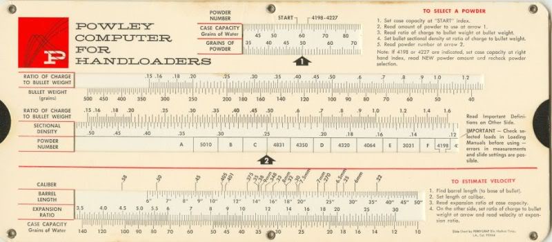

    Below is a Powley pocket computer, it is from the early 1960s and is used to compute the best powder charge weight and powder type using DuPont IMR series of powders.
    What it tells me is the theoretical "best load" for a .303 Britishicon and a 150 grain bullet is IMR-4064 powder and for the 180 grain bullet IMR-4350 is best.
    This information is nothing more than a theoretical WAG (wild A$$ guess) based on loading density and case capacity. The real answers come through testing with a chronograph and checking standard deviation and your group size.
    The "proof" is in the actual testing.
    You can compute and guesstimate a new jet engines thrust but you will NOT get the actual thrust figures until the engine is fired up and tested in a test cell.
